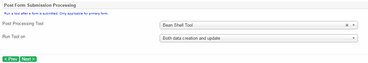

I'm using Post Processing Tool option after create/update form to run "process1" based on Bean Shell

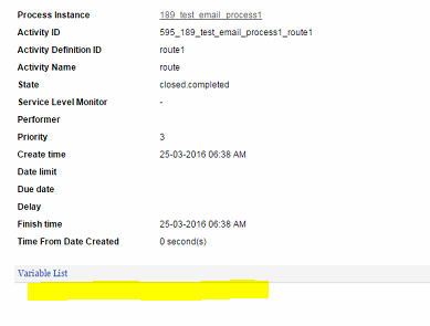

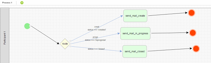

Unfortunately variable workflow "status" from the form is not visible and is not taken into consideration in the process, which causing process end already at the route point.
  • How can I modify existing java code to take as variable field from test_send_email.status ?
  • Any other option to make it? I don't want to add form to the below process - as this is only example and will be used for different purposes.
    The goal is to call a new process after form creation/update which will be sending email based on variable from that form.

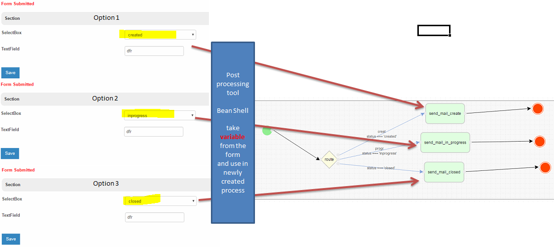

        It works, I have modified the code to take status based on select box selection instead to have fixed value "Created".
          new: variables.put("status","#form.test_send_email.status?java#");
           old: variables.put("status", "created");
        So the effect is as shown below.
