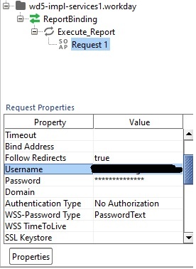

Here‘s the SOAP request from SoapUI.
Could it be because Soap Tool doesn't support WSSE security?

Add your comment... - 10-1attach the properties of soapUI request.Add your comment...
