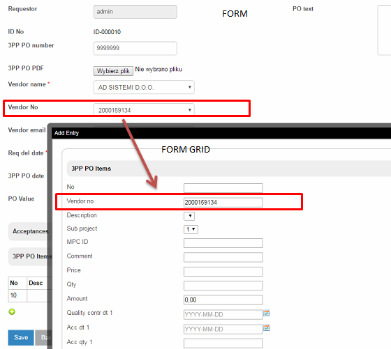

I need to populate data from one field in parent Form to second field in Grid Form form as shown below.

      Hi Satria,
      use below code, it works for me (you need to add Custom HTML in grid form and change naming for fields.
      BR,
      Sylwester
      //script which is populating data from parent table
          $(document).ready(function(){
              var mainFormField = "parent_field";
              var fieldId = "grid_field";
              //get value from parent form
              var value = $('[name='+mainFormField+']:enabled', window.parent.document).val();
              //store the value to a field
              $('[name='+fieldId+']:enabled').val(value);
      </script>

            Hi Sylwester Nowak,
            Maybe you can try this Javascript in the form grid's form:
            <script>
            var ParentValue = $('[name$=ParentFieldId]', window.parent.document).val();
            </script>
