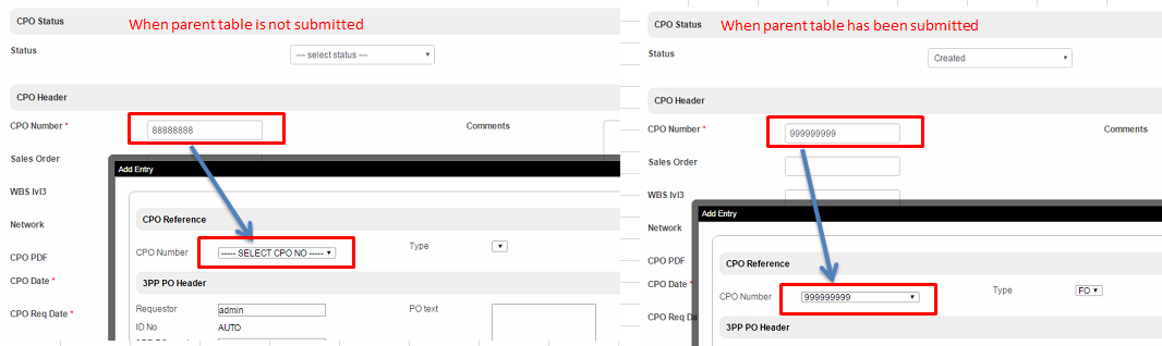

How can I transfer value from parent table to a child table, but in case parent table hasn't been submitted yet.
I was using below code, but it works only after parent table has been submitted before adding some grid elements.
Is it possible, if yes any idea how to make it?

      I just tried your script on my own app and it works even though the form is not submitted before.
      Try to insert "alert(value)" code or "console.log(value)" code somewhere in your code to debug.

        I also having the same problem...I use the same code and put the alert to see the value but the alert show "Undefined" value.
