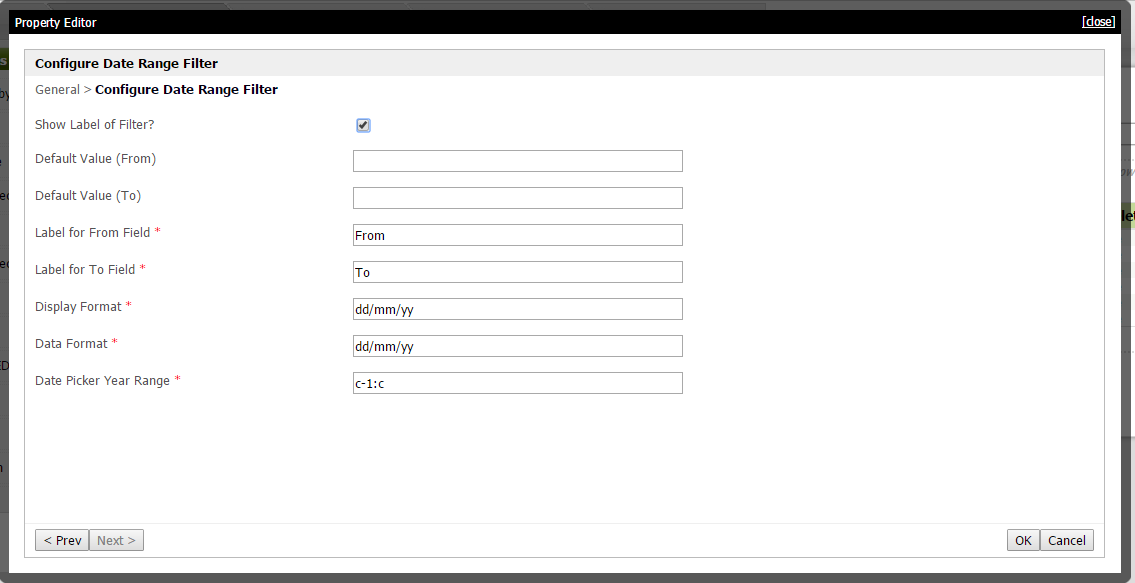

I think you may confused with the Display Format and Data Format.
You will need to check how the date is stored and what is it format in the database, then configure the "Data Format" of your date filter accordingly.
For example, the date is stored as "yyyy-MM-dd", then you should configure the "Data Format" of your date filter as "yyyy-MM-dd" as well.

Please refer to the documentation for Date Range Filter to provide equivalent jQuery and Java formats for dates.Let me know if you still face issues.

Did you use correct & equivalent date formats for jQuery & Java in the date range filter's configuration?
Also, are you getting any errors in the logs??Thanks.

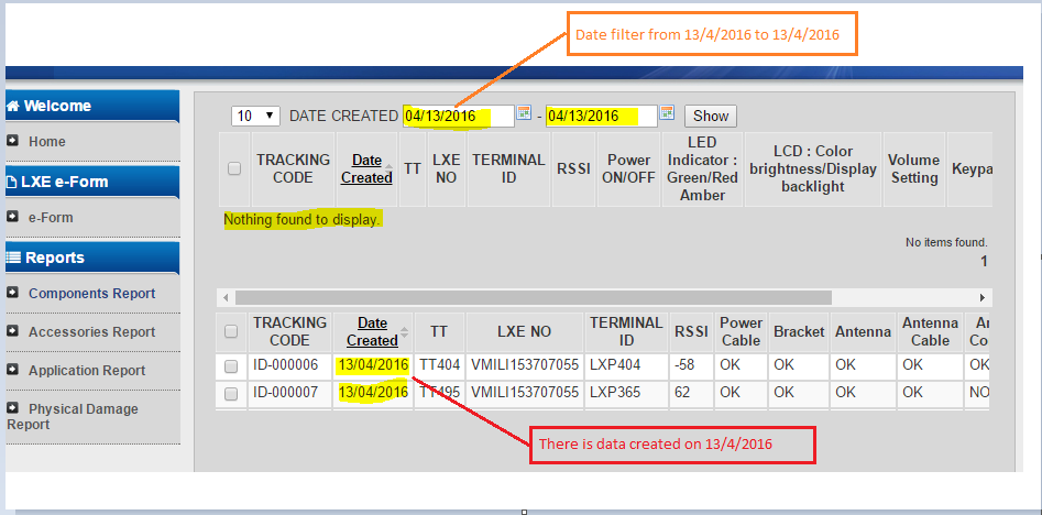

I still having the problem, when i filter the data in date range option

Where should i find date range filter's configuration?

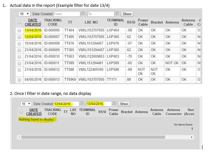

Unable to display data based on the filter date
Issue:
Data created on 13/4/2016 but not showing when it was filter in date range filter
