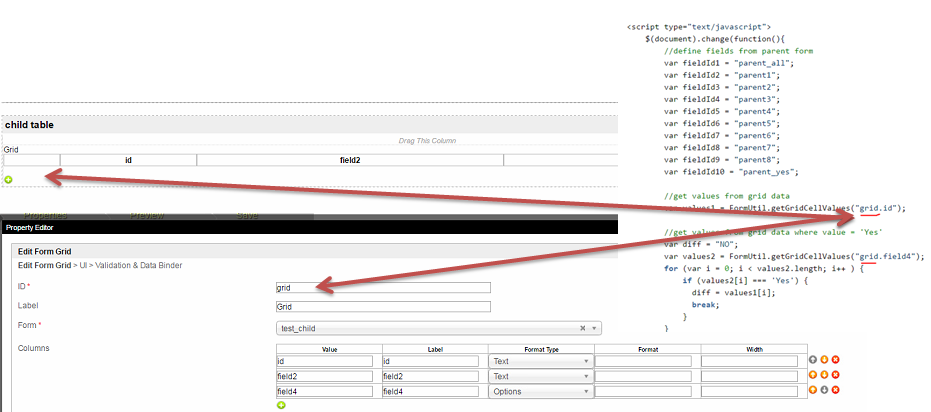

Hi Jedi,
it works for me, did you used correct reference to Grid table in javascript?
hi, i tried using this but my error log shows "FormUtil" was not defined. what will i do?
Just a suggestion, you may need to change your code to use FormUtil.getField to retrieve field to set value. FormUtil.getField will auto handle the case that this form is used as a subform.
<script type="text/javascript"> $(document).change(function(){ //define fields from parent form var fieldId1 = "parent_all"; var fieldId2 = "parent1"; var fieldId3 = "parent2"; var fieldId4 = "parent3"; var fieldId5 = "parent4"; var fieldId6 = "parent5"; var fieldId7 = "parent6"; var fieldId8 = "parent7"; var fieldId9 = "parent8"; var fieldId10 = "parent_yes"; //get values from grid data var values1 = FormUtil.getGridCellValues("grid.id"); //get values from grid data where value = 'Yes' var diff = "NO"; var values2 = FormUtil.getGridCellValues("grid.field4"); for (var i = 0; i < values2.length; i++ ) { if (values2[i] === 'Yes') { diff = values1[i]; break; } } /* NOTE: I would suggest you to use FormUtil.getField to retrieve field and set value. This will auto handle the case that this form is used as a subform. */ //store the value to a parent field FormUtil.getField(fieldId1).val(values1); FormUtil.getField(fieldId2).val(values1[0]); FormUtil.getField(fieldId3).val(values1[1]); FormUtil.getField(fieldId4).val(values1[2]); FormUtil.getField(fieldId5).val(values1[3]); FormUtil.getField(fieldId6).val(values1[4]); FormUtil.getField(fieldId7).val(values1[5]); FormUtil.getField(fieldId8).val(values1[6]); FormUtil.getField(fieldId9).val(values1[7]); //store the value to a parent field where value = 'YES' FormUtil.getField(fieldId10).val(diff); }); </script>

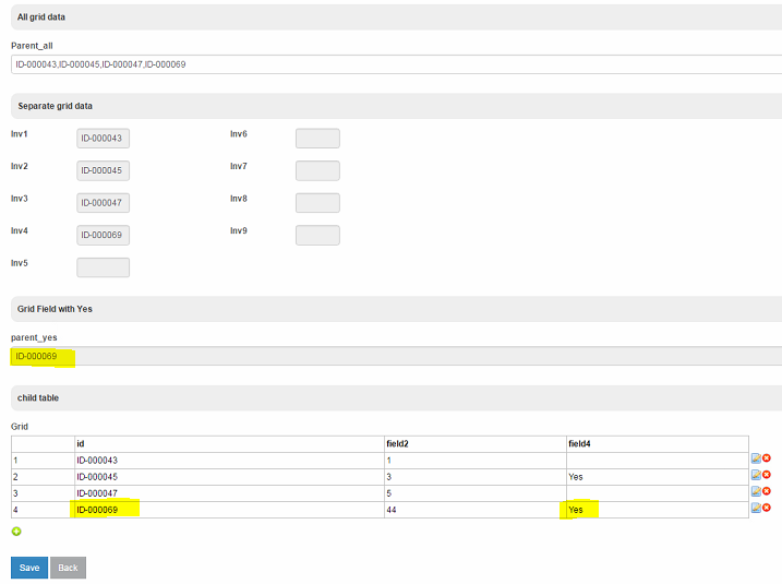

I have managed to make it, however in field parent_yes I'm getting always value for highest number with "yes".
It's fine for me (as the will be only one yes) but maybe anybody has better idea to make it?
<script type="text/javascript"> $(document).change(function(){ //define fields from parent form var fieldId1 = "parent_all"; var fieldId2 = "parent1"; var fieldId3 = "parent2"; var fieldId4 = "parent3"; var fieldId5 = "parent4"; var fieldId6 = "parent5"; var fieldId7 = "parent6"; var fieldId8 = "parent7"; var fieldId9 = "parent8"; var fieldId10 = "parent_yes"; //get values from grid data var values1 = FormUtil.getGridCellValues("grid.id"); for (var i = 0; i < values1.length; i++) { console.log(values1[i]); //i equals to row number start from 0 } //get values from grid data where value = 'Yes' var values2 = FormUtil.getGridCellValues("grid.field4"); for (var i = 0; i < values2.length; i++ ) { diff = "NO"; if (values2[0] == 'Yes') { diff = values1[0]; } if (values2[1] == 'Yes') { diff = values1[1]; } if (values2[2] == 'Yes') { diff = values1[2]; } if (values2[3] == 'Yes') { diff = values1[3]; } if (values2[4] == 'Yes') { diff = values1[4]; } if (values2[5] == 'Yes') { diff = values1[5]; } if (values2[6] == 'Yes') { diff = values1[6]; } if (values2[7] == 'Yes') { diff = values1[7]; } if (values2[8] == 'Yes') { diff = values1[8]; } if (values2[9] == 'Yes') { diff = values1[9]; } if (values2[10] == 'Yes') { diff = values1[10]; } } //store the value to a parent field $('[name='+fieldId1+']:enabled').val(values1); $('[name='+fieldId2+']:enabled').val(values1[0]); $('[name='+fieldId3+']:enabled').val(values1[1]); $('[name='+fieldId4+']:enabled').val(values1[2]); $('[name='+fieldId5+']:enabled').val(values1[3]); $('[name='+fieldId6+']:enabled').val(values1[4]); $('[name='+fieldId7+']:enabled').val(values1[5]); $('[name='+fieldId8+']:enabled').val(values1[6]); $('[name='+fieldId9+']:enabled').val(values1[7]); //store the value to a parent field where value = 'YES' $('[name='+fieldId10+']:enabled').val(diff); }); </script>

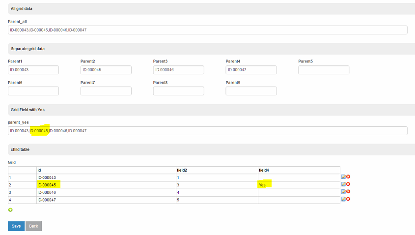

Now I have the following question, I would like to see in the parent form in field parent_yes field ID from child form where field4="Yes".
I believe I need to update somehow var values2 part with if condition eg. if grid,field4="Yes".
So in below case I would get result: ID-000045
Any luck with this one please?
<script type="text/javascript"> $(document).change(function(){ //define fields from parent form var fieldId1 = "parent_all"; var fieldId2 = "parent1"; var fieldId3 = "parent2"; var fieldId4 = "parent3"; var fieldId5 = "parent4"; var fieldId6 = "parent5"; var fieldId7 = "parent6"; var fieldId8 = "parent7"; var fieldId9 = "parent8"; var fieldId10 = "parent_yes"; //get values from grid data var values1 = FormUtil.getGridCellValues("grid.id"); for (var i = 0; i < values1.length; i++) { console.log(values1[i]); //i equals to row number start from 0 } //get values from grid data where value = 'Yes' var values2 = FormUtil.getGridCellValues("grid.id"); for (var i = 0; i < values2.length; i++ ) { console.log(values2[i]); //i equals to row number start from 0 } //store the value to a parent field $('[name='+fieldId1+']:enabled').val(values1); $('[name='+fieldId2+']:enabled').val(values1[0]); $('[name='+fieldId3+']:enabled').val(values1[1]); $('[name='+fieldId4+']:enabled').val(values1[2]); $('[name='+fieldId5+']:enabled').val(values1[3]); $('[name='+fieldId6+']:enabled').val(values1[4]); $('[name='+fieldId7+']:enabled').val(values1[5]); $('[name='+fieldId8+']:enabled').val(values1[6]); $('[name='+fieldId9+']:enabled').val(values1[7]); //store the value to a parent field where value = 'YES' $('[name='+fieldId10+']:enabled').val(values2); }); </script>

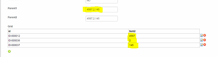

Hi All,
I have used below code to copy data from grid table to parent table (into speciefic field), it returns all grid data in an array.
How can I modify below code to have in parent table field Parent1 only speciefic record from Grid table field2, eg. only 3rd record so when i = 3 which means result 145.
Thanks for help in this one.
