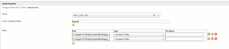

Hi All,

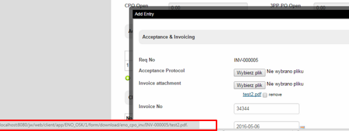

I have the following attachment in the form, and I want to include this attachment into email message.I cannot use Form / Form upload fields - as this is only example - will be used to other purpose.
http://localhost:8080/jw/web/client/app/ENO_OSK/1/form/download/eno_cpo_inv/INV-000005/test2.pdf.
Thanks,
Sylwester
  1. Sylwester Nowak
    Hi, I have managed to make it - it's simply location of file stored in Joget wflow. C:\Joget-v5-Enterprise\wflow\app_formuploads\eno_cpo_inv\INV-000005\test2.pdf BR, Sylwester

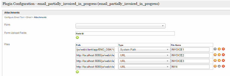

    Using Email Tool I have added csv attachment URL from a datalist, Still mail attachment file is wrong, Attachment file content is wrong. File include html content only, not the list i required.
    Immediate help appreciated
      whenever there's no attachment under speciefic link (through path functionality I mean the field where hash variable is reffering to is blank ) I'm getting server error, can I somehow overcome it?
      C:\Joget-v5-Enterprise\wflow\app_formuploads\eno_cpo_inv\#form.eno_cpo_inv.id[{form.eno_cpo.cpo_inv_attach_ready}]#\#form.eno_cpo_inv.cpo_inv_inv_attach[{form.eno_cpo.cpo_inv_attach_ready}]#
      ERROR 16 maj 2016 17:17:54 org.joget.apps.app.lib.EmailTool                   - org.apache.commons.mail.EmailException: Sending the email to the following server failed : smtp.gmail.com:587
      BR,
      Sylwester
        System path is the location of the file stored in the server, while URL is the URL to the file (smile)
