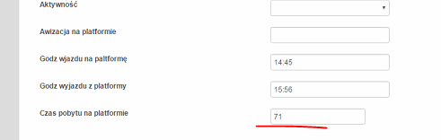

      I have managed to make it, as the time picker is text field, but I believe code could be further optimized.
      $(document).click(function(){
      var d1 = "godz_wjazdu_na_platf";
      var d2 = "godz_wyj_z_platf";
      var fieldId = "czas_pobytu";
      //get value from parent form
      var d3 = $('[name='+d1+']:enabled').val();
      var d4 = $('[name='+d2+']:enabled').val();
      // calculate number of minutes for first field
      var d5 = d3.substring(0, 2);
      var d6 = d3.substring(3, 5);
      var d7 = ((d5 * 60) + (d6 * 1));
      //calculate number of minutes for second field
      var d8 = d4.substring(0, 2);
      var d9 = d4.substring(3, 5);
      var d10 = ((d8 * 60) + (d9 * 1)) ;
      //final calculation (number of minutes)
      var d11= (d10 - d7) ;
      diff = d11; // ms per day
      //store the value to a field
      $('[name='+fieldId+']:enabled').val(diff);
      </script>
