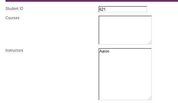

    The form will typically make use of the first item in FormRowSet unless you put these codes into those form elements that expect multiple objects in FormRowSet such as the FormGrid / Grid elements.

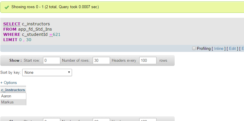

  3.
    Dear Bastiana,
    I have run the SQL Select statement on SQL client.
    The result has two records what i am expecting however in the Joget app only one one row is returning: I have attached below two screen shots instances for your reference:
    SQL statement:
    Joget App:
    Your response will be highly appreciated.
