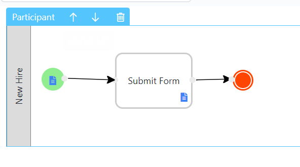

My process is very simple.

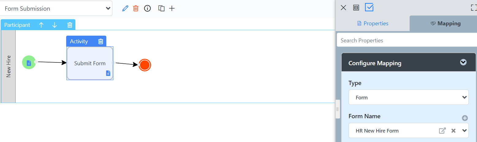

I mapped the Submit Form activity to the form that I want to be completed. Not sure if I have done this process correctly?
We need the form to be able to be viewed and filled out anonymously, so not logged in, I could not find this type of option for the Participant - is that normal?
Regards.
- Anders
To submit a form anonymously, you should use the Map Activities to Forms#RunProcess form mapping.
- Ian Walker
Hello Anders,
I believe I have done that.In the process diagram above Submit Form is the activity and I mapped to my form.
Did I do it properly?
Many thanks. - Anders
You should map the form to the start node actually.
