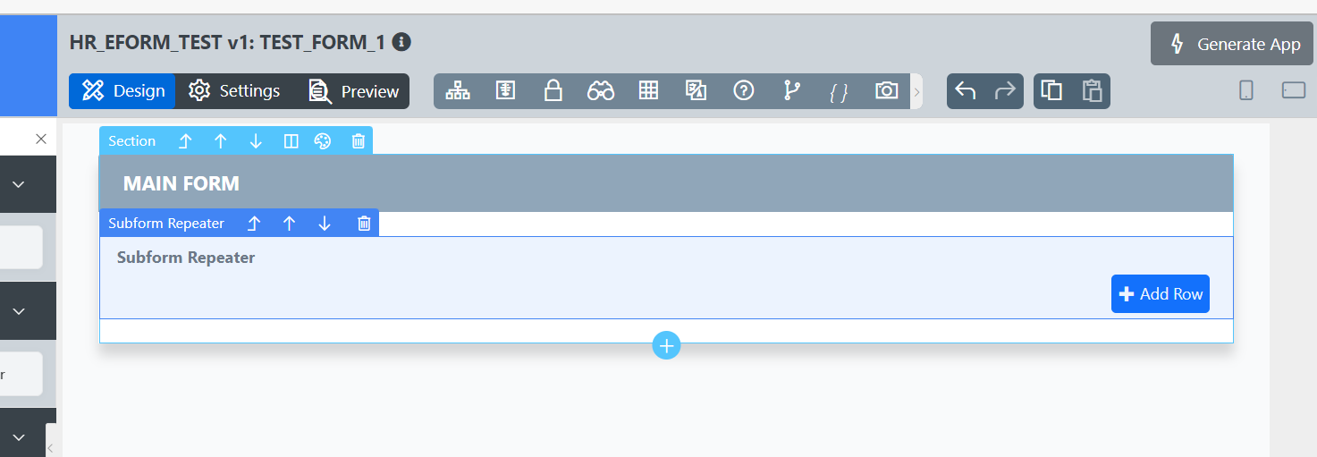

My main form looks like this, with a subform repeater linking to my second form that I will use as the subform.

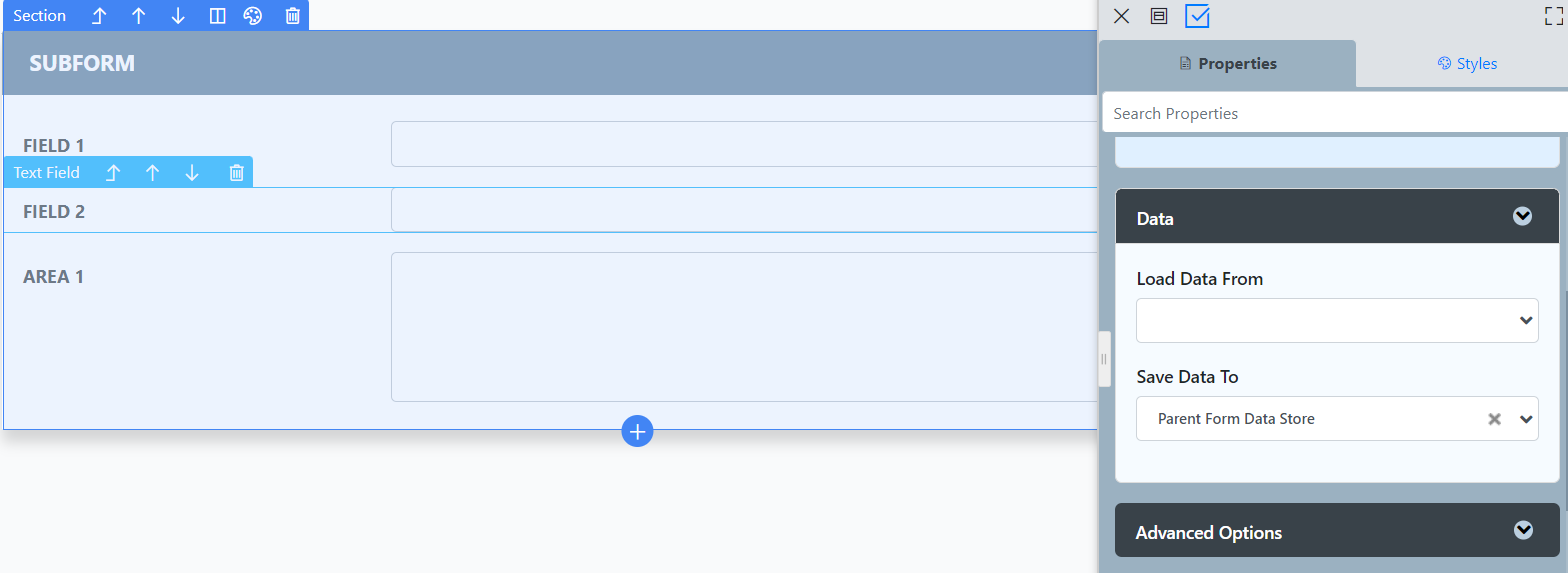

The subform looks like this, I also added a hidden FK field as the foreign key:For the subform data linkage, I put this:

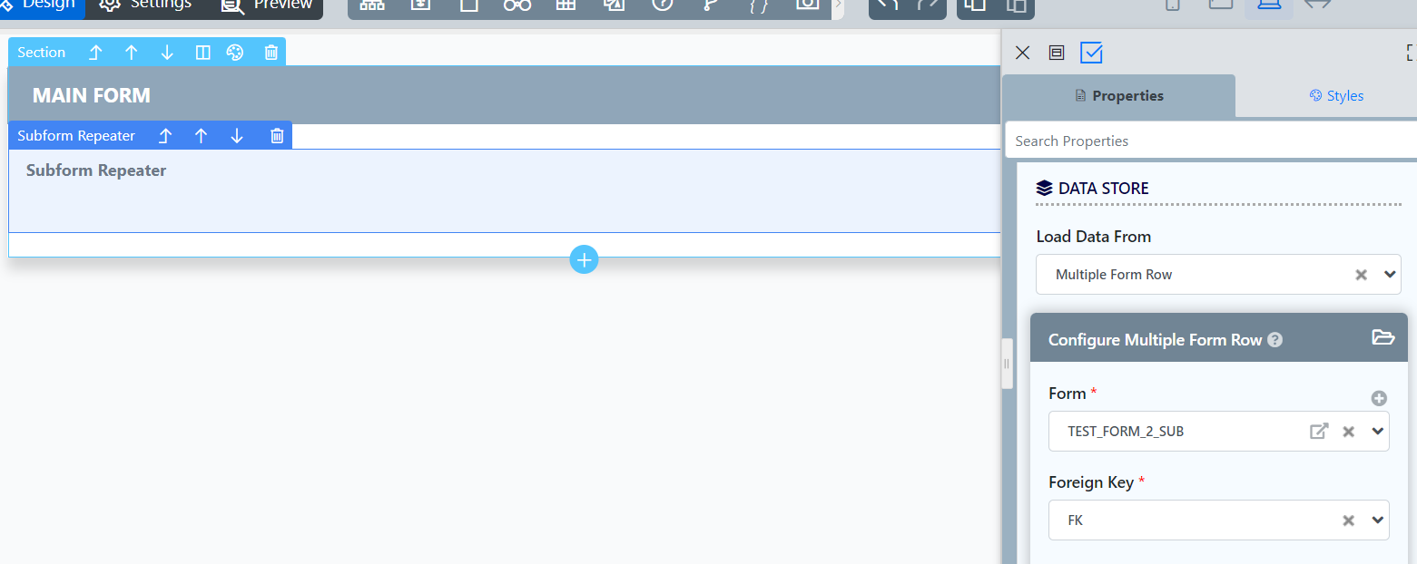

I did this to link the subform repeater to the subform via the FK field:

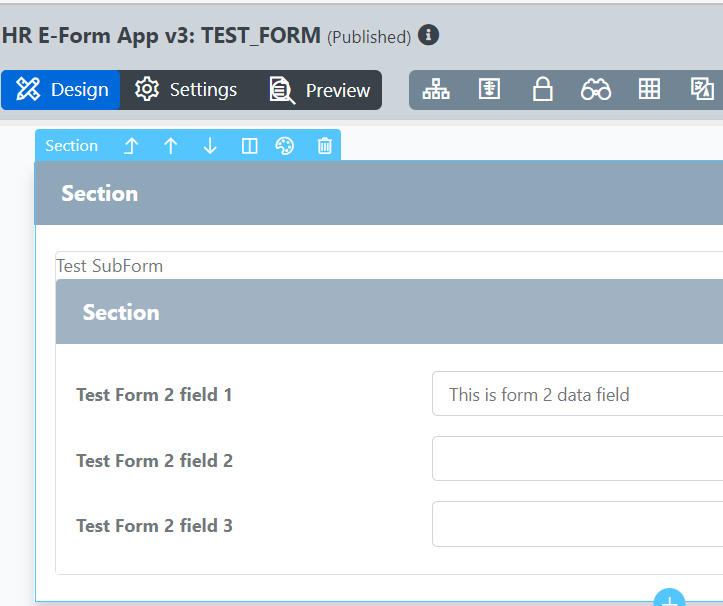

TESTFORM - this is my main form.
TESTFORM2 this is my subform.
TESTFORM has a subform repeater on it that links to TESTFORM2.
