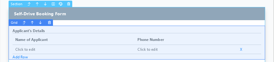

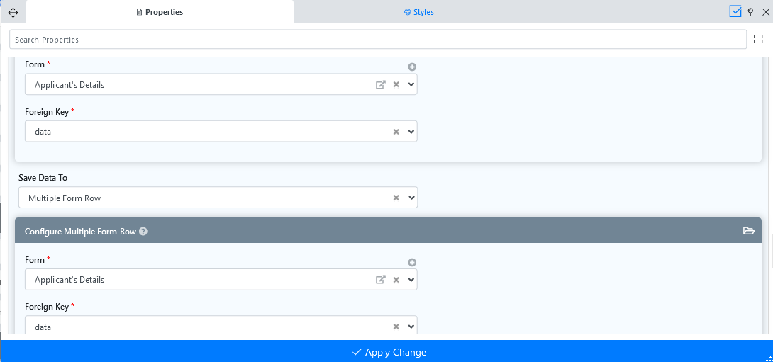

You can edit the grid and, choose the store and load to Multiple Form Row

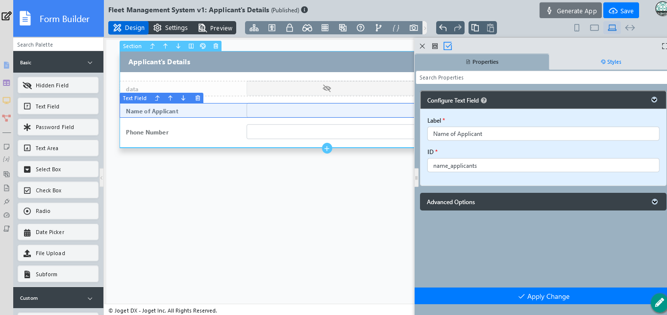

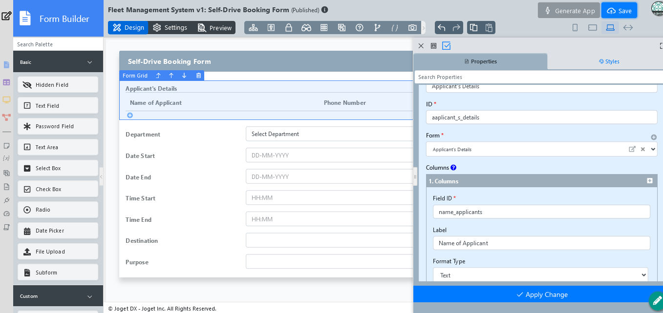

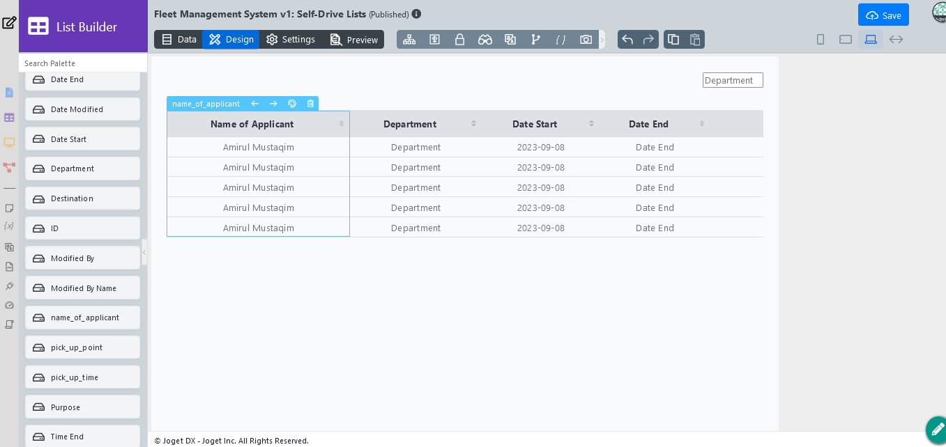

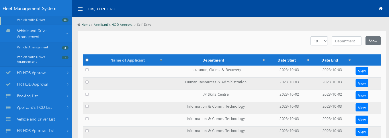

Hi Bastiana, now the list does not appear the name of the applicant even though I have followed the instructions. Can you tell me which part I did wrong?
The list also didn't have name_applicants ID

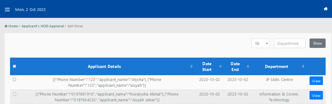

Hi, I am using Grid element for this form. Why the list listed as an array? Can you show me the correct way to appear it in the list?
