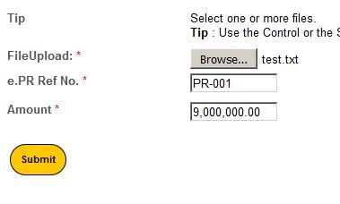

I have create a textfield as figure below:

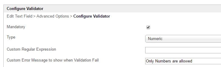

And I also create a HTML to add thousand seperator:
