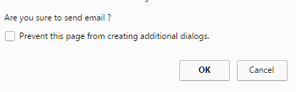

This is my code ,
$(document).ready(function(){
$("#assignmentComplete").on("click", function(){
     if(confirm("Are you sure to send email ?")){
          return true;
     }else{
          return false;
</script>
And this is , On submit form
And this is , On click cancel
Why, I don't see 'Please wait...'
Please Help Me!!!

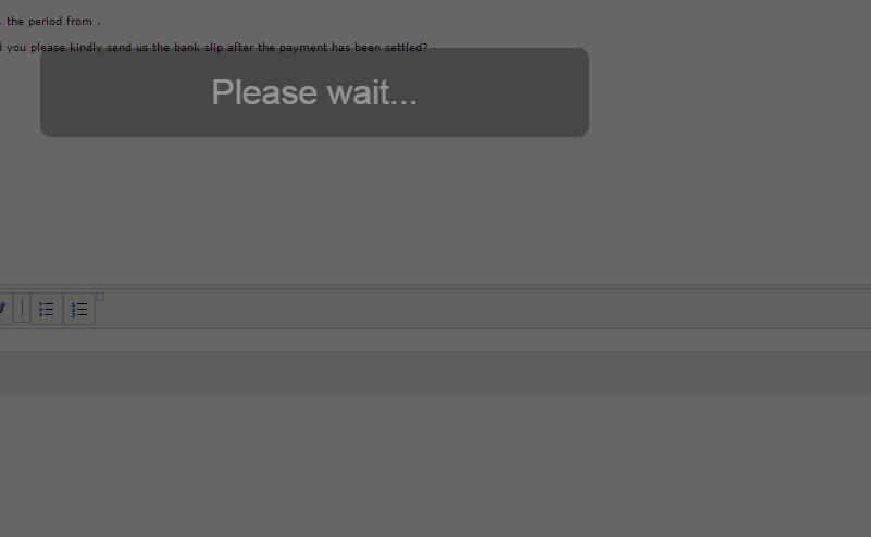

      I have improved Matthew's code to handle Joget v5 use of blockUI.
      $(document).ready(function() {
      		//cancel default click event in 1 second
      		setTimeout(function(){
      		    //uncomment this while loop if fails to remove default click event
      			//while( $("#section-actions button, #section-actions input").data("events") ){
      			  $("#section-actions button, #section-actions input").off("click");
      			$("#assignmentComplete,#submit").on("click", function(event) {
      				if (confirm("Are you sure to send email ?")) {
      					$.blockUI({ css: {
      						border: 'none',
      						padding: '15px',
      						backgroundColor: '#000',
      						'-webkit-border-radius': '10px',
      						'-moz-border-radius': '10px',
      						opacity: .3,
      						color: '#fff'
      					}, message : "<h1>Please wait...</h1>" });
      					return true;
      				} else {
      					return false;
      		}, 1000);
