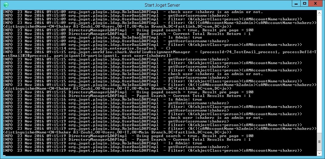

Even after turning off the Active directory debug mode,
and when checking the Joget.log
Still the below trace audit is appearing:
INFO 23 Nov 2016 15:56:54 org.joget.plugin.enterprise.SoapTool - {}
INFO 23 Nov 2016 15:56:55 org.joget.workflow.shark.WorkflowAssignmentManager - [processId=113_TestEmail_process1, processDefId=TestEmail#3#process1, participantId=participant1, next user=[shakerz]]Add your comment... - 10-1
I think you should check the log file instead of the console output. This is because you have the debug mode of LDAP directory manager turn on as well, there are too much debugging messages that clear the SOAP tool debugging message from your screen.
I used the same sample tool, I changed the webservice to an internal one.
but still there is no output,
even the log while the debug mode is active, it is not detecting the the webservice response. or to tace what is going on.
