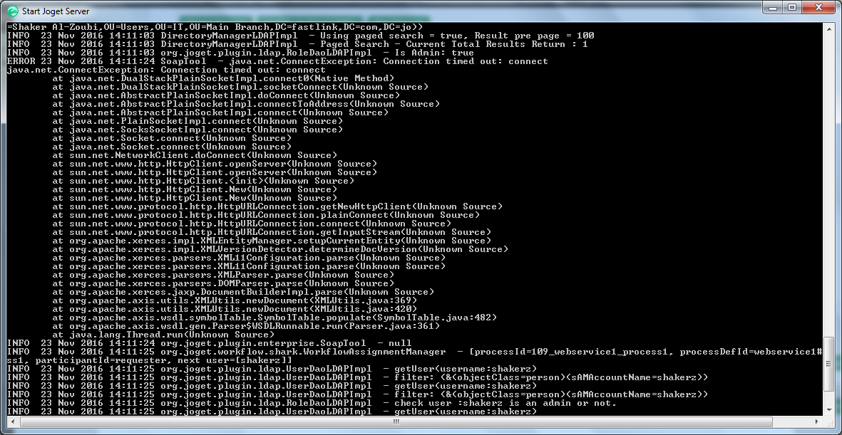

pls check up the log file now,

The error "java.net.ConnectException: Connection timed out: connect" indicates that you have a network connectivity issue from your server to the web service URL. Please check on that. For that Example 2, I just used a stock code like IBM, and got the results successfully.

I am already able to connect to wsdl file. pls see the below sample. in separate comment. Is the webservice have differant port.

Are you accessing the WSDL from your Joget Workflow server? The error "java.net.ConnectException: Connection timed out: connect" clearly indicates a connection problem.
