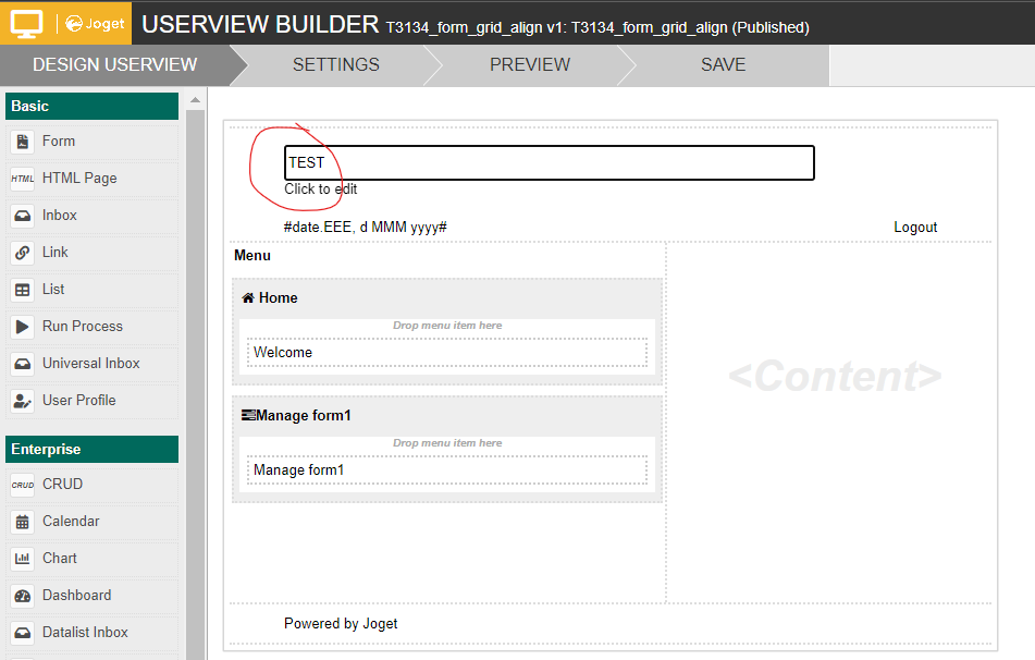

Yep, you can add a title. The version shown in my screenshot is DX7, yours is DX8.
- Ian Walker

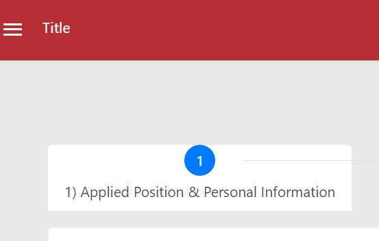

I found an option called 'Welcome Message' that seems to add a title.
Is it the same thing?
Thanks very much.
Hi, you can add a title to the top of the userview in the Userview builder. Here's a screenshot of where to find it:
As for the logo, I think you can adjust the dimensions and the positioning via CSS in the Home Banner Section found in the Advanced setting of the Userview builder.
- Ian Walker

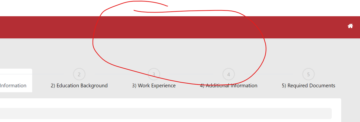

Hello Everyone.
How can I add a title to this part of the userview - the header?
Also, when viewing the form on mobile, I have added a logo to be displayed. However, it seems to stick to the top edges of the form, how can I stop this? How can it be centered properly?
I edited the image in an image manipulation program to give it a gap between the top of the canvas area and the image, but when I add it to Joget it seems to ignore it?
