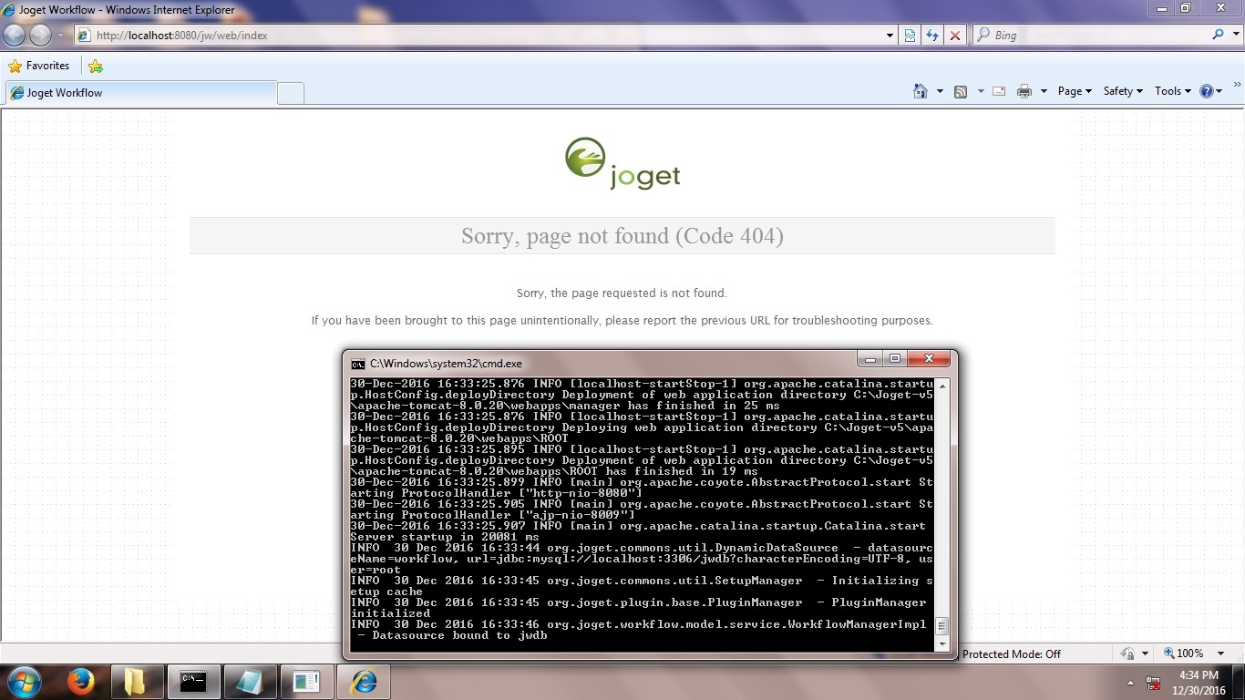

Hi, it should be a database connection configuration issue as Bastiana mentioned. It would be good to read http://stackoverflow.com/help/how-to-ask on the way to ask a good question.
It is very likely that Joget can't connect to the said database. Try to verify the connectivity to the database using the parameters defined in your datasource profile OR you can...
- shutdown the server,
- delete the datasource profile,
- restart the server, and follow the steps in Setting Up Database to point to your new database.

hI I AM UNABLE TO CONFIGURE JOGET WITH MYSQL 5.5 I HAD CONFIGURED EVERY THING THERE IS A ERROR WHILE OPENING PAGE PLEASE CHECK IT ONCE
