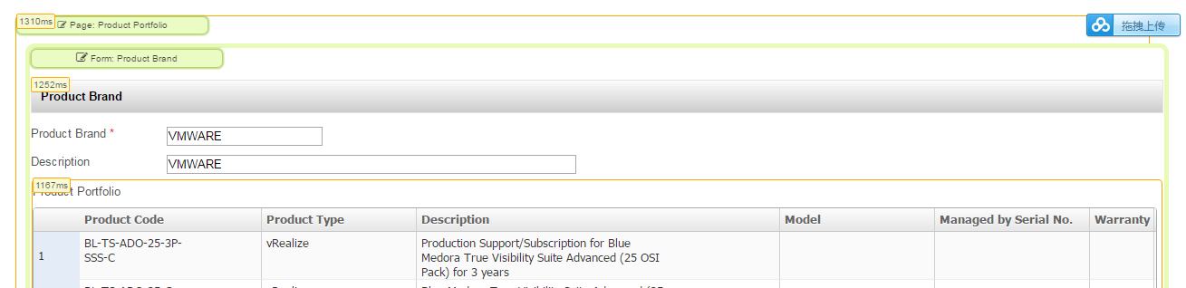

I am using the Joget Version 5 with Advance Grid. How never we facing slow performance to show the data in the grid with 400 records.
It took around 10 sec to show the page at the browser. However the performance analysier just show 1100+ ms only.
Anyway can tune a better performance .

          the performance of loading the grid from the database is acceptable which is just only around 1 sec.

        Understand your point of view. but there only have advance Grid got the features of Inline Editing, So I have no other options for OOTB. However, is it any reason behind that the Advance Grid(pqGrid) need to duplicate the data for 3 times? And pq-Grid should able to support data paging and it should no need to load all the record in once, as I set the grid on display 20 rows per page. Anyway how I can enable this feature?
