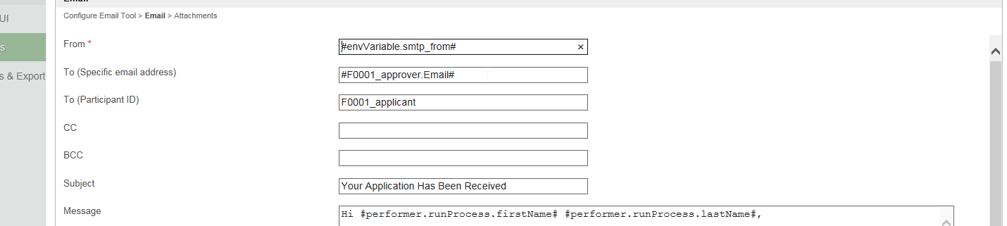

Hello, in my case, I am using in the "To" field:
#user.{Variable.applicant}.email#
Where 'applicant' is actually a workflow variable that contains a username. This is because I need to send a communication to a specific user and not a group.
In case it is the whole group to which the notification should be sent, I do not use a Tool, but I use the "User Notification" plugin in a global way for the whole app.

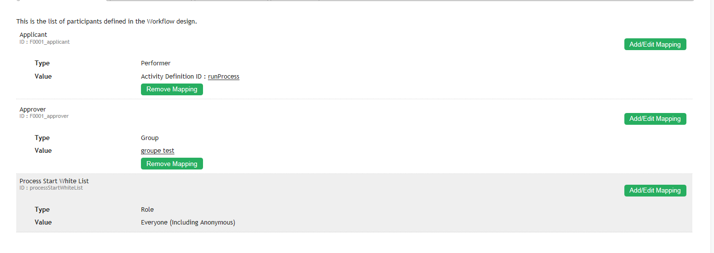

I did everything, not capital letter, declared as workflow variable from the process diagram as well as in the form and map participants to user. But still not working. Really need help for this.
Hi, i'm trying to import the variable Email from all the group that i link to approver.
As I saw in one of your video, you are using the syntax #—# to import the value "Email" for each user with a email in this group. Thank you very much for your answer!
