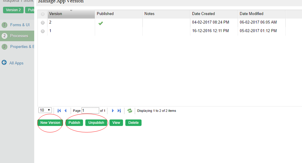

You can generate as many versions of the same process as you need. However, you must keep one (only one) as public (or current). Here is the problem of instances that remain with previous versions of the process, which Joget handles with the philosophy of "with the version that started, will end" and does not lose the transaction of active instances even if new instances of the process can not be generated in other versions than the published one.

Well said. I would like to refine your statement a bit - process instance will stay "with the APP version that started". More at https://dev.joget.org/community/display/KBv5/Update+Existing+Running+Process+Instances+to+the+Newer+Process+Flow+After+Process+Changes

It look like you can have more than one version for form etc... but I couldn't find a way to have multiple processes version!
