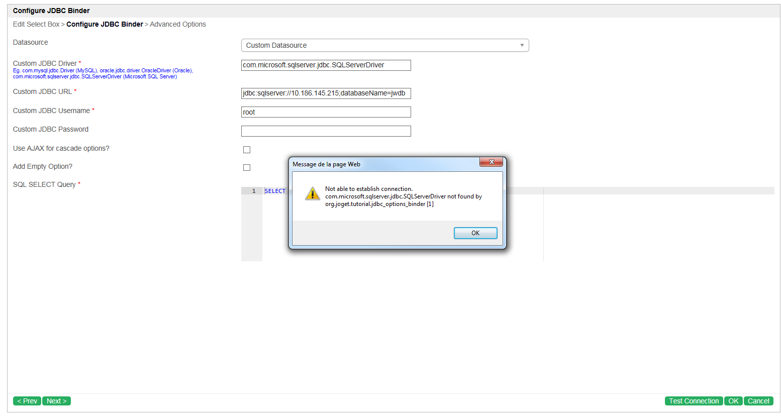

I am not sure where I am suppose to look for the classpath? Where is it situated? Thank you very much
- Jonatan nadeau
I have download this: https://www.microsoft.com/en-us/download/confirmation.aspx?id=11774 Then I extract the thing and after I put the jre8\sqljdbc42.executableJarFile In the tomcat_appache/lib. It still doesn't work. I put a picture what it wrote when it come to the jdbc driver. Thank you very much.

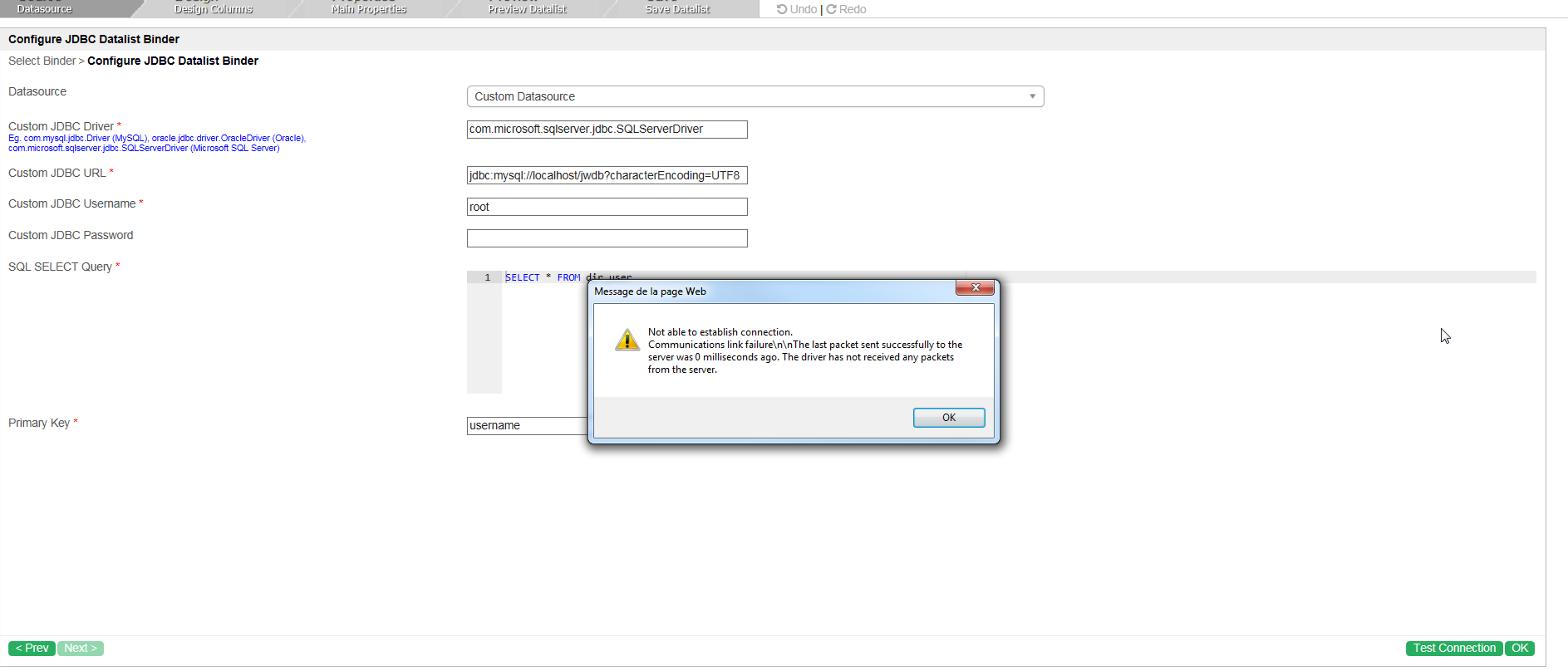

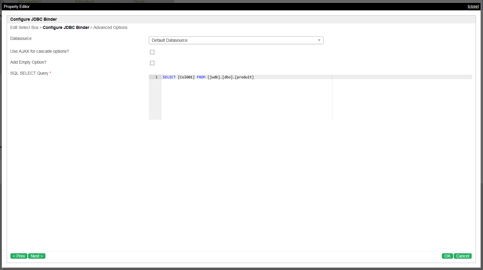

I'm trying to populate a selectBox with a table in the default database used by joget.
I tried to connect the other way, but the driver isn't found.

I tried two weeks ago to connect with this jdbc driver, and joget was able to find it. I really don't know how I can resolve this problem.
Here's a proof
