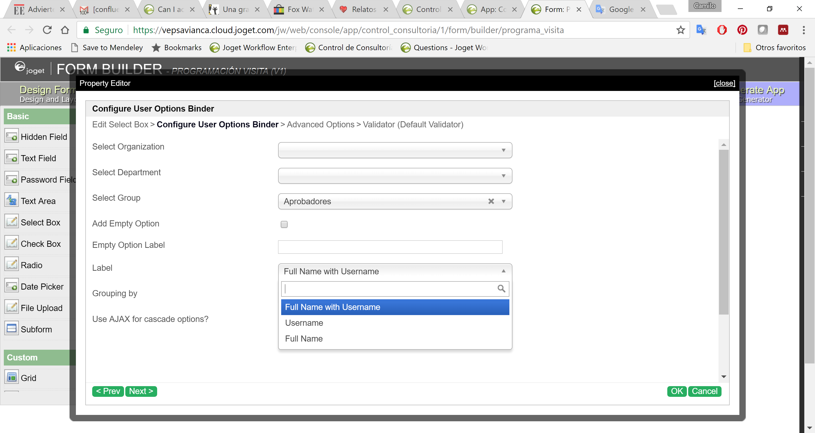

      Hello, regarding the first question about what to display in the listbox from the list of users, if you look closely, in the second screen of options in "label" you can choose to show:

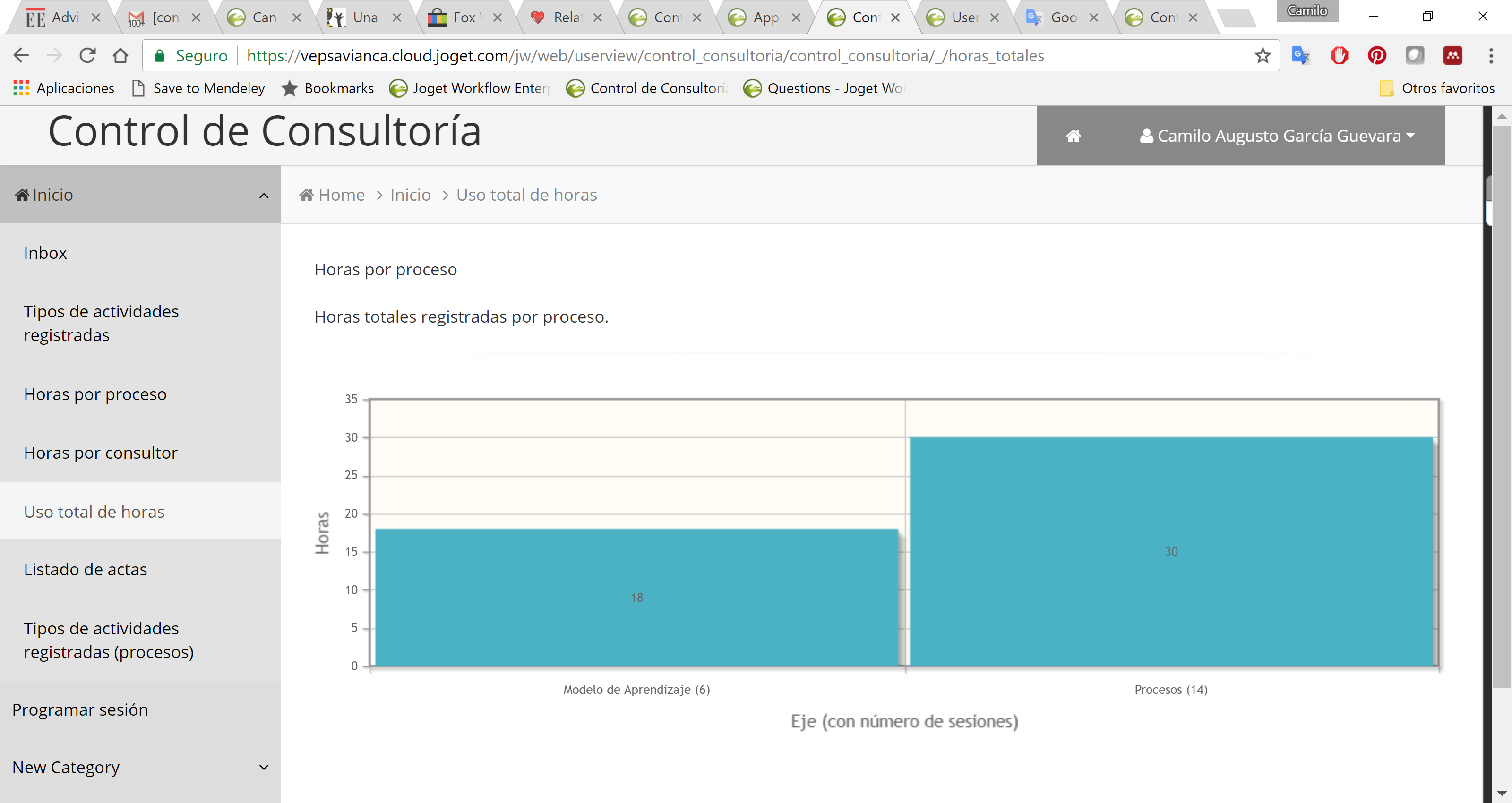

      Although it is for something else, the following query:
      SELECT
      CONCAT(app_fd_dom_ejes_proyecto.c_nom_eje, ' (', count(*)       , ')') as name,
      sum(
      TIMESTAMPDIFF(HOUR , concat('2000:01:01',' ',STR_TO_DATE(c_hora_inicio, '%H:%i')), concat('2000:01:01',' ',STR_TO_DATE(c_hora_final, '%H:%i')))
      as horas
      from
      app_fd_spro_visitas,
      where
      app_fd_spro_visitas.c_id_eje=app_fd_dom_ejes_proyecto.c_id_eje
      group by app_fd_dom_ejes_proyecto.c_nom_eje
      Produces this graph:
