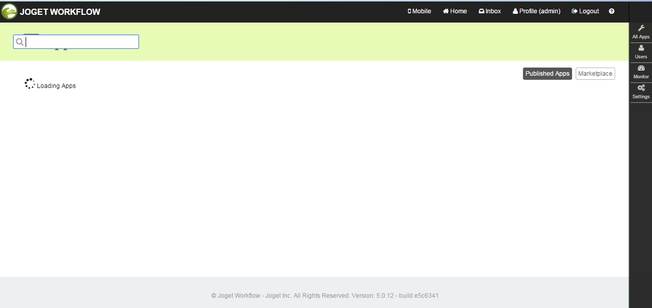

Hi, the error message says that a db table column is missing, which should be automatically created. Did you follow all the steps in Running Joget Workflow with Oracle 11g? Especially the permissions to make sure that your connection user has sufficient privileges to alter tables.
- Ali Hosseini
I Execute This tutorial...But...
Hello
I Has This Error After Login To Joget, When Will Show App
ERROR 05 Apr 2017 16:05:40 org.hibernate.engine.jdbc.spi.SqlExceptionHelper - O RA-00904: "APPDEFINIT0_"."META": invalid identifier ERROR 05 Apr 2017 16:05:40 org.joget.commons.spring.web.CustomDelegatingFilterPr oxy - Request processing failed; nested exception is org.hibernate.exception.SQ LGrammarException: could not extract ResultSet org.springframework.web.util.NestedServletException: Request processing failed; nested exception is org.hibernate.exception.SQLGrammarException: could not extra ct ResultSet at org.springframework.web.servlet.FrameworkServlet.processRequest(Frame workServlet.java:978) at org.springframework.web.servlet.FrameworkServlet.doGet(FrameworkServl et.java:857) at javax.servlet.http.HttpServlet.service(HttpServlet.java:618) at org.springframework.web.servlet.FrameworkServlet.service(FrameworkSer vlet.java:842) at javax.servlet.http.HttpServlet.service(HttpServlet.java:725) at org.apache.catalina.core.ApplicationFilterChain.internalDoFilter(Appl icationFilterChain.java:291) at org.apache.catalina.core.ApplicationFilterChain.doFilter(ApplicationF ilterChain.java:206) at org.apache.tomcat.websocket.server.WsFilter.doFilter(WsFilter.java:52 ) at org.apache.catalina.core.ApplicationFilterChain.internalDoFilter(Appl icationFilterChain.java:239) at org.apache.catalina.core.ApplicationFilterChain.doFilter(ApplicationF ilterChain.java:206) at org.displaytag.filter.ResponseOverrideFilter.doFilter(ResponseOverrid eFilter.java:125) at org.apache.catalina.core.ApplicationFilterChain.internalDoFilter(Appl icationFilterChain.java:239) at org.apache.catalina.core.ApplicationFilterChain.doFilter(ApplicationF ilterChain.java:206) at org.owasp.csrfguard.CsrfGuardFilter.doFilter(CsrfGuardFilter.java:88) at org.apache.catalina.core.ApplicationFilterChain.internalDoFilter(Appl icationFilterChain.java:239) at org.apache.catalina.core.ApplicationFilterChain.doFilter(ApplicationF ilterChain.java:206) at org.springframework.security.web.FilterChainProxy$VirtualFilterChain. doFilter(FilterChainProxy.java:316) at org.springframework.security.web.access.intercept.FilterSecurityInter ceptor.invoke(FilterSecurityInterceptor.java:126) at org.springframework.security.web.access.intercept.FilterSecurityInter ceptor.doFilter(FilterSecurityInterceptor.java:90) at org.springframework.security.web.FilterChainProxy$VirtualFilterChain. doFilter(FilterChainProxy.java:330) at org.springframework.security.web.access.ExceptionTranslationFilter.do Filter(ExceptionTranslationFilter.java:114) at org.springframework.security.web.FilterChainProxy$VirtualFilterChain. doFilter(FilterChainProxy.java:330) at org.springframework.security.web.session.SessionManagementFilter.doFi lter(SessionManagementFilter.java:122) at org.springframework.security.web.FilterChainProxy$VirtualFilterChain. doFilter(FilterChainProxy.java:330) at org.springframework.security.web.authentication.AnonymousAuthenticati onFilter.doFilter(AnonymousAuthenticationFilter.java:111) at org.springframework.security.web.FilterChainProxy$VirtualFilterChain. doFilter(FilterChainProxy.java:330) at org.springframework.security.web.savedrequest.RequestCacheAwareFilter .doFilter(RequestCacheAwareFilter.java:48) at org.springframework.security.web.FilterChainProxy$VirtualFilterChain. doFilter(FilterChainProxy.java:330) at org.springframework.security.web.authentication.AbstractAuthenticatio nProcessingFilter.doFilter(AbstractAuthenticationProcessingFilter.java:205) at org.joget.apps.workflow.security.WorkflowHttpAuthProcessingFilter.doF ilter(WorkflowHttpAuthProcessingFilter.java:84) at org.springframework.security.web.FilterChainProxy$VirtualFilterChain. doFilter(FilterChainProxy.java:330) at org.springframework.security.web.authentication.www.BasicAuthenticati onFilter.doFilterInternal(BasicAuthenticationFilter.java:158) at org.springframework.web.filter.OncePerRequestFilter.doFilter(OncePerR equestFilter.java:107) at org.springframework.security.web.FilterChainProxy$VirtualFilterChain. doFilter(FilterChainProxy.java:330) at org.springframework.security.web.authentication.AbstractAuthenticatio nProcessingFilter.doFilter(AbstractAuthenticationProcessingFilter.java:205) at org.springframework.security.web.FilterChainProxy$VirtualFilterChain. doFilter(FilterChainProxy.java:330) at org.springframework.security.web.authentication.logout.LogoutFilter.d oFilter(LogoutFilter.java:120) at org.springframework.security.web.FilterChainProxy$VirtualFilterChain. doFilter(FilterChainProxy.java:330) at org.springframework.security.web.header.HeaderWriterFilter.doFilterIn ternal(HeaderWriterFilter.java:64) at org.springframework.web.filter.OncePerRequestFilter.doFilter(OncePerR equestFilter.java:107) at org.springframework.security.web.FilterChainProxy$VirtualFilterChain. doFilter(FilterChainProxy.java:330) at org.springframework.security.web.context.request.async.WebAsyncManage rIntegrationFilter.doFilterInternal(WebAsyncManagerIntegrationFilter.java:53) at org.springframework.web.filter.OncePerRequestFilter.doFilter(OncePerR equestFilter.java:107) at org.springframework.security.web.FilterChainProxy$VirtualFilterChain. doFilter(FilterChainProxy.java:330) at org.springframework.security.web.context.SecurityContextPersistenceFi lter.doFilter(SecurityContextPersistenceFilter.java:91) at org.springframework.security.web.FilterChainProxy$VirtualFilterChain. doFilter(FilterChainProxy.java:330) at org.springframework.security.web.FilterChainProxy.doFilterInternal(Fi lterChainProxy.java:213) at org.springframework.security.web.FilterChainProxy.doFilter(FilterChai nProxy.java:176) at org.springframework.web.filter.DelegatingFilterProxy.invokeDelegate(D elegatingFilterProxy.java:344) at org.springframework.web.filter.DelegatingFilterProxy.doFilter(Delegat ingFilterProxy.java:261) at org.joget.commons.spring.web.CustomDelegatingFilterProxy.doFilter(Cus tomDelegatingFilterProxy.java:30) at org.apache.catalina.core.ApplicationFilterChain.internalDoFilter(Appl icationFilterChain.java:239) at org.apache.catalina.core.ApplicationFilterChain.doFilter(ApplicationF ilterChain.java:206) at org.joget.apps.app.web.ExpireFilter.doFilter(ExpireFilter.java:43) at org.apache.catalina.core.ApplicationFilterChain.internalDoFilter(Appl icationFilterChain.java:239) at org.apache.catalina.core.ApplicationFilterChain.doFilter(ApplicationF ilterChain.java:206) at org.joget.apps.app.web.JsonResponseFilter.doFilter(JsonResponseFilter .java:138) at org.apache.catalina.core.ApplicationFilterChain.internalDoFilter(Appl icationFilterChain.java:239) at org.apache.catalina.core.ApplicationFilterChain.doFilter(ApplicationF ilterChain.java:206) at org.springframework.web.filter.CharacterEncodingFilter.doFilterIntern al(CharacterEncodingFilter.java:85) at org.springframework.web.filter.OncePerRequestFilter.doFilter(OncePerR equestFilter.java:107) at org.apache.catalina.core.ApplicationFilterChain.internalDoFilter(Appl icationFilterChain.java:239) at org.apache.catalina.core.ApplicationFilterChain.doFilter(ApplicationF ilterChain.java:206) at org.apache.catalina.core.StandardWrapperValve.invoke(StandardWrapperV alve.java:219) at org.apache.catalina.core.StandardContextValve.invoke(StandardContextV alve.java:106) at org.apache.catalina.authenticator.AuthenticatorBase.invoke(Authentica torBase.java:501) at org.apache.catalina.core.StandardHostValve.invoke(StandardHostValve.j ava:142) at org.apache.catalina.valves.ErrorReportValve.invoke(ErrorReportValve.j ava:79) at org.apache.catalina.core.StandardEngineValve.invoke(StandardEngineVal ve.java:88) at org.apache.catalina.connector.CoyoteAdapter.service(CoyoteAdapter.jav a:516) at org.apache.coyote.http11.AbstractHttp11Processor.process(AbstractHttp 11Processor.java:1086) at org.apache.coyote.AbstractProtocol$AbstractConnectionHandler.process( AbstractProtocol.java:659) at org.apache.coyote.http11.Http11NioProtocol$Http11ConnectionHandler.pr ocess(Http11NioProtocol.java:223) at org.apache.tomcat.util.net.NioEndpoint$SocketProcessor.doRun(NioEndpo int.java:1558) at org.apache.tomcat.util.net.NioEndpoint$SocketProcessor.run(NioEndpoin t.java:1515) at java.util.concurrent.ThreadPoolExecutor.runWorker(Unknown Source) at java.util.concurrent.ThreadPoolExecutor$Worker.run(Unknown Source) at org.apache.tomcat.util.threads.TaskThread$WrappingRunnable.run(TaskTh read.java:61) at java.lang.Thread.run(Unknown Source) Caused by: org.hibernate.exception.SQLGrammarException: could not extract Result Set at org.hibernate.exception.internal.SQLExceptionTypeDelegate.convert(SQL ExceptionTypeDelegate.java:80) at org.hibernate.exception.internal.StandardSQLExceptionConverter.conver t(StandardSQLExceptionConverter.java:49) at org.hibernate.engine.jdbc.spi.SqlExceptionHelper.convert(SqlException Helper.java:126) at org.hibernate.engine.jdbc.spi.SqlExceptionHelper.convert(SqlException Helper.java:112) at org.hibernate.engine.jdbc.internal.ResultSetReturnImpl.extract(Result SetReturnImpl.java:91) at org.hibernate.loader.Loader.getResultSet(Loader.java:2066) at org.hibernate.loader.Loader.executeQueryStatement(Loader.java:1863) at org.hibernate.loader.Loader.executeQueryStatement(Loader.java:1839) at org.hibernate.loader.Loader.doQuery(Loader.java:910) at org.hibernate.loader.Loader.doQueryAndInitializeNonLazyCollections(Lo ader.java:355) at org.hibernate.loader.Loader.doList(Loader.java:2554) at org.hibernate.loader.Loader.doList(Loader.java:2540) at org.hibernate.loader.Loader.listIgnoreQueryCache(Loader.java:2370) at org.hibernate.loader.Loader.list(Loader.java:2365) at org.hibernate.loader.hql.QueryLoader.list(QueryLoader.java:497) at org.hibernate.hql.internal.ast.QueryTranslatorImpl.list(QueryTranslat orImpl.java:387) at org.hibernate.engine.query.spi.HQLQueryPlan.performList(HQLQueryPlan. java:236) at org.hibernate.internal.SessionImpl.list(SessionImpl.java:1300) at org.hibernate.internal.QueryImpl.list(QueryImpl.java:103) at org.joget.apps.app.dao.AppDefinitionDaoImpl.findPublishedApps(AppDefi nitionDaoImpl.java:97) at sun.reflect.NativeMethodAccessorImpl.invoke0(Native Method) at sun.reflect.NativeMethodAccessorImpl.invoke(Unknown Source) at sun.reflect.DelegatingMethodAccessorImpl.invoke(Unknown Source) at java.lang.reflect.Method.invoke(Unknown Source) at org.springframework.aop.support.AopUtils.invokeJoinpointUsingReflecti on(AopUtils.java:317) at org.springframework.aop.framework.ReflectiveMethodInvocation.invokeJo inpoint(ReflectiveMethodInvocation.java:190) at org.springframework.aop.framework.ReflectiveMethodInvocation.proceed( ReflectiveMethodInvocation.java:157) at org.springframework.transaction.interceptor.TransactionInterceptor$1. proceedWithInvocation(TransactionInterceptor.java:99) at org.springframework.transaction.interceptor.TransactionAspectSupport. invokeWithinTransaction(TransactionAspectSupport.java:281) at org.springframework.transaction.interceptor.TransactionInterceptor.in voke(TransactionInterceptor.java:96) at org.springframework.aop.framework.ReflectiveMethodInvocation.proceed( ReflectiveMethodInvocation.java:179) at org.springframework.aop.interceptor.ExposeInvocationInterceptor.invok e(ExposeInvocationInterceptor.java:92) at org.springframework.aop.framework.ReflectiveMethodInvocation.proceed( ReflectiveMethodInvocation.java:179) at org.springframework.aop.framework.JdkDynamicAopProxy.invoke(JdkDynami cAopProxy.java:207) at com.sun.proxy.$Proxy33.findPublishedApps(Unknown Source) at org.joget.apps.app.service.AppServiceImpl.getPublishedApps(AppService Impl.java:2080) at org.joget.apps.app.service.AppServiceImpl.getPublishedApps(AppService Impl.java:2063) at sun.reflect.NativeMethodAccessorImpl.invoke0(Native Method) at sun.reflect.NativeMethodAccessorImpl.invoke(Unknown Source) at sun.reflect.DelegatingMethodAccessorImpl.invoke(Unknown Source) at java.lang.reflect.Method.invoke(Unknown Source) at org.springframework.aop.support.AopUtils.invokeJoinpointUsingReflecti on(AopUtils.java:317) at org.springframework.aop.framework.JdkDynamicAopProxy.invoke(JdkDynami cAopProxy.java:201) at com.sun.proxy.$Proxy54.getPublishedApps(Unknown Source) at org.joget.apps.workflow.controller.WorkflowJsonController.publishedAp ps(WorkflowJsonController.java:1056) at sun.reflect.NativeMethodAccessorImpl.invoke0(Native Method) at sun.reflect.NativeMethodAccessorImpl.invoke(Unknown Source) at sun.reflect.DelegatingMethodAccessorImpl.invoke(Unknown Source) at java.lang.reflect.Method.invoke(Unknown Source) at org.springframework.web.bind.annotation.support.HandlerMethodInvoker. invokeHandlerMethod(HandlerMethodInvoker.java:177) at org.springframework.web.servlet.mvc.annotation.AnnotationMethodHandle rAdapter.invokeHandlerMethod(AnnotationMethodHandlerAdapter.java:446) at org.springframework.web.servlet.mvc.annotation.AnnotationMethodHandle rAdapter.handle(AnnotationMethodHandlerAdapter.java:434) at org.joget.commons.spring.web.ParameterizedAnnotationMethodHandlerAdap ter.handle(ParameterizedAnnotationMethodHandlerAdapter.java:32) at org.springframework.web.servlet.DispatcherServlet.doDispatch(Dispatch erServlet.java:959) at org.springframework.web.servlet.DispatcherServlet.doService(Dispatche rServlet.java:893) at org.springframework.web.servlet.FrameworkServlet.processRequest(Frame workServlet.java:966) ... 78 more Caused by: java.sql.SQLSyntaxErrorException: ORA-00904: "APPDEFINIT0_"."META": i nvalid identifier at oracle.jdbc.driver.T4CTTIoer.processError(T4CTTIoer.java:450) at oracle.jdbc.driver.T4CTTIoer.processError(T4CTTIoer.java:399) at oracle.jdbc.driver.T4C8Oall.processError(T4C8Oall.java:1059) at oracle.jdbc.driver.T4CTTIfun.receive(T4CTTIfun.java:522) at oracle.jdbc.driver.T4CTTIfun.doRPC(T4CTTIfun.java:257) at oracle.jdbc.driver.T4C8Oall.doOALL(T4C8Oall.java:587) at oracle.jdbc.driver.T4CPreparedStatement.doOall8(T4CPreparedStatement. java:225) at oracle.jdbc.driver.T4CPreparedStatement.doOall8(T4CPreparedStatement. java:53) at oracle.jdbc.driver.T4CPreparedStatement.executeForDescribe(T4CPrepare dStatement.java:774) at oracle.jdbc.driver.OracleStatement.executeMaybeDescribe(OracleStateme nt.java:925) at oracle.jdbc.driver.OracleStatement.doExecuteWithTimeout(OracleStateme nt.java:1111) at oracle.jdbc.driver.OraclePreparedStatement.executeInternal(OraclePrep aredStatement.java:4798) at oracle.jdbc.driver.OraclePreparedStatement.executeQuery(OraclePrepare dStatement.java:4845) at oracle.jdbc.driver.OraclePreparedStatementWrapper.executeQuery(Oracle PreparedStatementWrapper.java:1501) at org.apache.commons.dbcp.DelegatingPreparedStatement.executeQuery(Dele gatingPreparedStatement.java:96) at org.apache.commons.dbcp.DelegatingPreparedStatement.executeQuery(Dele gatingPreparedStatement.java:96) at org.hibernate.engine.jdbc.internal.ResultSetReturnImpl.extract(Result SetReturnImpl.java:82) ... 129 more ERROR 05 Apr 2017 16:05:40 org.joget.apps.app.web.JsonResponseFilter - org.hibe rnate.exception.SQLGrammarException: could not extract ResultSet org.hibernate.exception.SQLGrammarException: could not extract ResultSet at org.hibernate.exception.internal.SQLExceptionTypeDelegate.convert(SQL ExceptionTypeDelegate.java:80) at org.hibernate.exception.internal.StandardSQLExceptionConverter.conver t(StandardSQLExceptionConverter.java:49) at org.hibernate.engine.jdbc.spi.SqlExceptionHelper.convert(SqlException Helper.java:126) at org.hibernate.engine.jdbc.spi.SqlExceptionHelper.convert(SqlException Helper.java:112) at org.hibernate.engine.jdbc.internal.ResultSetReturnImpl.extract(Result SetReturnImpl.java:91) at org.hibernate.loader.Loader.getResultSet(Loader.java:2066) at org.hibernate.loader.Loader.executeQueryStatement(Loader.java:1863) at org.hibernate.loader.Loader.executeQueryStatement(Loader.java:1839) at org.hibernate.loader.Loader.doQuery(Loader.java:910) at org.hibernate.loader.Loader.doQueryAndInitializeNonLazyCollections(Lo ader.java:355) at org.hibernate.loader.Loader.doList(Loader.java:2554) at org.hibernate.loader.Loader.doList(Loader.java:2540) at org.hibernate.loader.Loader.listIgnoreQueryCache(Loader.java:2370) at org.hibernate.loader.Loader.list(Loader.java:2365) at org.hibernate.loader.hql.QueryLoader.list(QueryLoader.java:497) at org.hibernate.hql.internal.ast.QueryTranslatorImpl.list(QueryTranslat orImpl.java:387) at org.hibernate.engine.query.spi.HQLQueryPlan.performList(HQLQueryPlan. java:236) at org.hibernate.internal.SessionImpl.list(SessionImpl.java:1300) at org.hibernate.internal.QueryImpl.list(QueryImpl.java:103) at org.joget.apps.app.dao.AppDefinitionDaoImpl.findPublishedApps(AppDefi nitionDaoImpl.java:97) at sun.reflect.NativeMethodAccessorImpl.invoke0(Native Method) at sun.reflect.NativeMethodAccessorImpl.invoke(Unknown Source) at sun.reflect.DelegatingMethodAccessorImpl.invoke(Unknown Source) at java.lang.reflect.Method.invoke(Unknown Source) at org.springframework.aop.support.AopUtils.invokeJoinpointUsingReflecti on(AopUtils.java:317) at org.springframework.aop.framework.ReflectiveMethodInvocation.invokeJo inpoint(ReflectiveMethodInvocation.java:190) at org.springframework.aop.framework.ReflectiveMethodInvocation.proceed( ReflectiveMethodInvocation.java:157) at org.springframework.transaction.interceptor.TransactionInterceptor$1. proceedWithInvocation(TransactionInterceptor.java:99) at org.springframework.transaction.interceptor.TransactionAspectSupport. invokeWithinTransaction(TransactionAspectSupport.java:281) at org.springframework.transaction.interceptor.TransactionInterceptor.in voke(TransactionInterceptor.java:96) at org.springframework.aop.framework.ReflectiveMethodInvocation.proceed( ReflectiveMethodInvocation.java:179) at org.springframework.aop.interceptor.ExposeInvocationInterceptor.invok e(ExposeInvocationInterceptor.java:92) at org.springframework.aop.framework.ReflectiveMethodInvocation.proceed( ReflectiveMethodInvocation.java:179) at org.springframework.aop.framework.JdkDynamicAopProxy.invoke(JdkDynami cAopProxy.java:207) at com.sun.proxy.$Proxy33.findPublishedApps(Unknown Source) at org.joget.apps.app.service.AppServiceImpl.getPublishedApps(AppService Impl.java:2080) at org.joget.apps.app.service.AppServiceImpl.getPublishedApps(AppService Impl.java:2063) at sun.reflect.NativeMethodAccessorImpl.invoke0(Native Method) at sun.reflect.NativeMethodAccessorImpl.invoke(Unknown Source) at sun.reflect.DelegatingMethodAccessorImpl.invoke(Unknown Source) at java.lang.reflect.Method.invoke(Unknown Source) at org.springframework.aop.support.AopUtils.invokeJoinpointUsingReflecti on(AopUtils.java:317) at org.springframework.aop.framework.JdkDynamicAopProxy.invoke(JdkDynami cAopProxy.java:201) at com.sun.proxy.$Proxy54.getPublishedApps(Unknown Source) at org.joget.apps.workflow.controller.WorkflowJsonController.publishedAp ps(WorkflowJsonController.java:1056) at sun.reflect.NativeMethodAccessorImpl.invoke0(Native Method) at sun.reflect.NativeMethodAccessorImpl.invoke(Unknown Source) at sun.reflect.DelegatingMethodAccessorImpl.invoke(Unknown Source) at java.lang.reflect.Method.invoke(Unknown Source) at org.springframework.web.bind.annotation.support.HandlerMethodInvoker. invokeHandlerMethod(HandlerMethodInvoker.java:177) at org.springframework.web.servlet.mvc.annotation.AnnotationMethodHandle rAdapter.invokeHandlerMethod(AnnotationMethodHandlerAdapter.java:446) at org.springframework.web.servlet.mvc.annotation.AnnotationMethodHandle rAdapter.handle(AnnotationMethodHandlerAdapter.java:434) at org.joget.commons.spring.web.ParameterizedAnnotationMethodHandlerAdap ter.handle(ParameterizedAnnotationMethodHandlerAdapter.java:32) at org.springframework.web.servlet.DispatcherServlet.doDispatch(Dispatch erServlet.java:959) at org.springframework.web.servlet.DispatcherServlet.doService(Dispatche rServlet.java:893) at org.springframework.web.servlet.FrameworkServlet.processRequest(Frame workServlet.java:966) at org.springframework.web.servlet.FrameworkServlet.doGet(FrameworkServl et.java:857) at javax.servlet.http.HttpServlet.service(HttpServlet.java:618) at org.springframework.web.servlet.FrameworkServlet.service(FrameworkSer vlet.java:842) at javax.servlet.http.HttpServlet.service(HttpServlet.java:725) at org.apache.catalina.core.ApplicationFilterChain.internalDoFilter(Appl icationFilterChain.java:291) at org.apache.catalina.core.ApplicationFilterChain.doFilter(ApplicationF ilterChain.java:206) at org.apache.tomcat.websocket.server.WsFilter.doFilter(WsFilter.java:52 ) at org.apache.catalina.core.ApplicationFilterChain.internalDoFilter(Appl icationFilterChain.java:239) at org.apache.catalina.core.ApplicationFilterChain.doFilter(ApplicationF ilterChain.java:206) at org.displaytag.filter.ResponseOverrideFilter.doFilter(ResponseOverrid eFilter.java:125) at org.apache.catalina.core.ApplicationFilterChain.internalDoFilter(Appl icationFilterChain.java:239) at org.apache.catalina.core.ApplicationFilterChain.doFilter(ApplicationF ilterChain.java:206) at org.owasp.csrfguard.CsrfGuardFilter.doFilter(CsrfGuardFilter.java:88) at org.apache.catalina.core.ApplicationFilterChain.internalDoFilter(Appl icationFilterChain.java:239) at org.apache.catalina.core.ApplicationFilterChain.doFilter(ApplicationF ilterChain.java:206) at org.springframework.security.web.FilterChainProxy$VirtualFilterChain. doFilter(FilterChainProxy.java:316) at org.springframework.security.web.access.intercept.FilterSecurityInter ceptor.invoke(FilterSecurityInterceptor.java:126) at org.springframework.security.web.access.intercept.FilterSecurityInter ceptor.doFilter(FilterSecurityInterceptor.java:90) at org.springframework.security.web.FilterChainProxy$VirtualFilterChain. doFilter(FilterChainProxy.java:330) at org.springframework.security.web.access.ExceptionTranslationFilter.do Filter(ExceptionTranslationFilter.java:114) at org.springframework.security.web.FilterChainProxy$VirtualFilterChain. doFilter(FilterChainProxy.java:330) at org.springframework.security.web.session.SessionManagementFilter.doFi lter(SessionManagementFilter.java:122) at org.springframework.security.web.FilterChainProxy$VirtualFilterChain. doFilter(FilterChainProxy.java:330) at org.springframework.security.web.authentication.AnonymousAuthenticati onFilter.doFilter(AnonymousAuthenticationFilter.java:111) at org.springframework.security.web.FilterChainProxy$VirtualFilterChain. doFilter(FilterChainProxy.java:330) at org.springframework.security.web.savedrequest.RequestCacheAwareFilter .doFilter(RequestCacheAwareFilter.java:48) at org.springframework.security.web.FilterChainProxy$VirtualFilterChain. doFilter(FilterChainProxy.java:330) at org.springframework.security.web.authentication.AbstractAuthenticatio nProcessingFilter.doFilter(AbstractAuthenticationProcessingFilter.java:205) at org.joget.apps.workflow.security.WorkflowHttpAuthProcessingFilter.doF ilter(WorkflowHttpAuthProcessingFilter.java:84) at org.springframework.security.web.FilterChainProxy$VirtualFilterChain. doFilter(FilterChainProxy.java:330) at org.springframework.security.web.authentication.www.BasicAuthenticati onFilter.doFilterInternal(BasicAuthenticationFilter.java:158) at org.springframework.web.filter.OncePerRequestFilter.doFilter(OncePerR equestFilter.java:107) at org.springframework.security.web.FilterChainProxy$VirtualFilterChain. doFilter(FilterChainProxy.java:330) at org.springframework.security.web.authentication.AbstractAuthenticatio nProcessingFilter.doFilter(AbstractAuthenticationProcessingFilter.java:205) at org.springframework.security.web.FilterChainProxy$VirtualFilterChain. doFilter(FilterChainProxy.java:330) at org.springframework.security.web.authentication.logout.LogoutFilter.d oFilter(LogoutFilter.java:120) at org.springframework.security.web.FilterChainProxy$VirtualFilterChain. doFilter(FilterChainProxy.java:330) at org.springframework.security.web.header.HeaderWriterFilter.doFilterIn ternal(HeaderWriterFilter.java:64) at org.springframework.web.filter.OncePerRequestFilter.doFilter(OncePerR equestFilter.java:107) at org.springframework.security.web.FilterChainProxy$VirtualFilterChain. doFilter(FilterChainProxy.java:330) at org.springframework.security.web.context.request.async.WebAsyncManage rIntegrationFilter.doFilterInternal(WebAsyncManagerIntegrationFilter.java:53) at org.springframework.web.filter.OncePerRequestFilter.doFilter(OncePerR equestFilter.java:107) at org.springframework.security.web.FilterChainProxy$VirtualFilterChain. doFilter(FilterChainProxy.java:330) at org.springframework.security.web.context.SecurityContextPersistenceFi lter.doFilter(SecurityContextPersistenceFilter.java:91) at org.springframework.security.web.FilterChainProxy$VirtualFilterChain. doFilter(FilterChainProxy.java:330) at org.springframework.security.web.FilterChainProxy.doFilterInternal(Fi lterChainProxy.java:213) at org.springframework.security.web.FilterChainProxy.doFilter(FilterChai nProxy.java:176) at org.springframework.web.filter.DelegatingFilterProxy.invokeDelegate(D elegatingFilterProxy.java:344) at org.springframework.web.filter.DelegatingFilterProxy.doFilter(Delegat ingFilterProxy.java:261) at org.joget.commons.spring.web.CustomDelegatingFilterProxy.doFilter(Cus tomDelegatingFilterProxy.java:30) at org.apache.catalina.core.ApplicationFilterChain.internalDoFilter(Appl icationFilterChain.java:239) at org.apache.catalina.core.ApplicationFilterChain.doFilter(ApplicationF ilterChain.java:206) at org.joget.apps.app.web.ExpireFilter.doFilter(ExpireFilter.java:43) at org.apache.catalina.core.ApplicationFilterChain.internalDoFilter(Appl icationFilterChain.java:239) at org.apache.catalina.core.ApplicationFilterChain.doFilter(ApplicationF ilterChain.java:206) at org.joget.apps.app.web.JsonResponseFilter.doFilter(JsonResponseFilter .java:138) at org.apache.catalina.core.ApplicationFilterChain.internalDoFilter(Appl icationFilterChain.java:239) at org.apache.catalina.core.ApplicationFilterChain.doFilter(ApplicationF ilterChain.java:206) at org.springframework.web.filter.CharacterEncodingFilter.doFilterIntern al(CharacterEncodingFilter.java:85) at org.springframework.web.filter.OncePerRequestFilter.doFilter(OncePerR equestFilter.java:107) at org.apache.catalina.core.ApplicationFilterChain.internalDoFilter(Appl icationFilterChain.java:239) at org.apache.catalina.core.ApplicationFilterChain.doFilter(ApplicationF ilterChain.java:206) at org.apache.catalina.core.StandardWrapperValve.invoke(StandardWrapperV alve.java:219) at org.apache.catalina.core.StandardContextValve.invoke(StandardContextV alve.java:106) at org.apache.catalina.authenticator.AuthenticatorBase.invoke(Authentica torBase.java:501) at org.apache.catalina.core.StandardHostValve.invoke(StandardHostValve.j ava:142) at org.apache.catalina.valves.ErrorReportValve.invoke(ErrorReportValve.j ava:79) at org.apache.catalina.core.StandardEngineValve.invoke(StandardEngineVal ve.java:88) at org.apache.catalina.connector.CoyoteAdapter.service(CoyoteAdapter.jav a:516) at org.apache.coyote.http11.AbstractHttp11Processor.process(AbstractHttp 11Processor.java:1086) at org.apache.coyote.AbstractProtocol$AbstractConnectionHandler.process( AbstractProtocol.java:659) at org.apache.coyote.http11.Http11NioProtocol$Http11ConnectionHandler.pr ocess(Http11NioProtocol.java:223) at org.apache.tomcat.util.net.NioEndpoint$SocketProcessor.doRun(NioEndpo int.java:1558) at org.apache.tomcat.util.net.NioEndpoint$SocketProcessor.run(NioEndpoin t.java:1515) at java.util.concurrent.ThreadPoolExecutor.runWorker(Unknown Source) at java.util.concurrent.ThreadPoolExecutor$Worker.run(Unknown Source) at org.apache.tomcat.util.threads.TaskThread$WrappingRunnable.run(TaskTh read.java:61) at java.lang.Thread.run(Unknown Source) Caused by: java.sql.SQLSyntaxErrorException: ORA-00904: "APPDEFINIT0_"."META": i nvalid identifier at oracle.jdbc.driver.T4CTTIoer.processError(T4CTTIoer.java:450) at oracle.jdbc.driver.T4CTTIoer.processError(T4CTTIoer.java:399) at oracle.jdbc.driver.T4C8Oall.processError(T4C8Oall.java:1059) at oracle.jdbc.driver.T4CTTIfun.receive(T4CTTIfun.java:522) at oracle.jdbc.driver.T4CTTIfun.doRPC(T4CTTIfun.java:257) at oracle.jdbc.driver.T4C8Oall.doOALL(T4C8Oall.java:587) at oracle.jdbc.driver.T4CPreparedStatement.doOall8(T4CPreparedStatement. java:225) at oracle.jdbc.driver.T4CPreparedStatement.doOall8(T4CPreparedStatement. java:53) at oracle.jdbc.driver.T4CPreparedStatement.executeForDescribe(T4CPrepare dStatement.java:774) at oracle.jdbc.driver.OracleStatement.executeMaybeDescribe(OracleStateme nt.java:925) at oracle.jdbc.driver.OracleStatement.doExecuteWithTimeout(OracleStateme nt.java:1111) at oracle.jdbc.driver.OraclePreparedStatement.executeInternal(OraclePrep aredStatement.java:4798) at oracle.jdbc.driver.OraclePreparedStatement.executeQuery(OraclePrepare dStatement.java:4845) at oracle.jdbc.driver.OraclePreparedStatementWrapper.executeQuery(Oracle PreparedStatementWrapper.java:1501) at org.apache.commons.dbcp.DelegatingPreparedStatement.executeQuery(Dele gatingPreparedStatement.java:96) at org.apache.commons.dbcp.DelegatingPreparedStatement.executeQuery(Dele gatingPreparedStatement.java:96) at org.hibernate.engine.jdbc.internal.ResultSetReturnImpl.extract(Result SetReturnImpl.java:82) ... 129 moreHelp Me....
