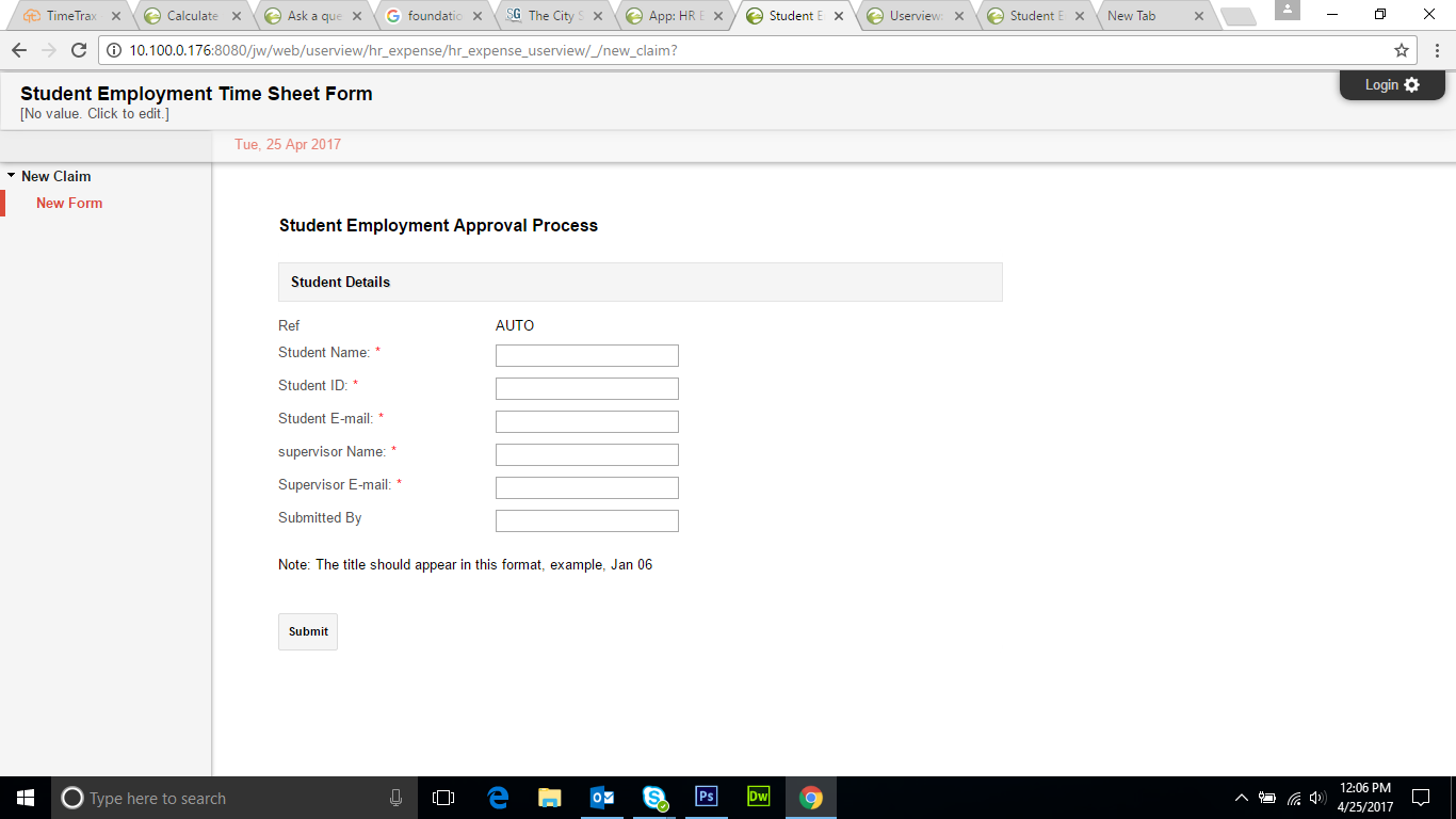

I want to ask that how can I give URL of the form to anonymous users. basically i want to built a public form for everyone then it will be filled by them and approved by specific appointed logged user.
So which URL i will provide to anonymous users?
 Below is my public form for everyone. How can i generate its URL?
      If you want anonymous users to be able to submit a form and you want that submission to kick-off a process instance in Joget wherein you'd be creating assignments for someone to approve the details filled in the form, you'd need to keep a few things in mind:

      Now for the next part of your question, what URL are we talking about? The URL given to a person would need to be the link to your runtime userview's runProcess element which is the same you've shown in your screenshot. Based on what approach you'd follow, you can share the URL with your users.
