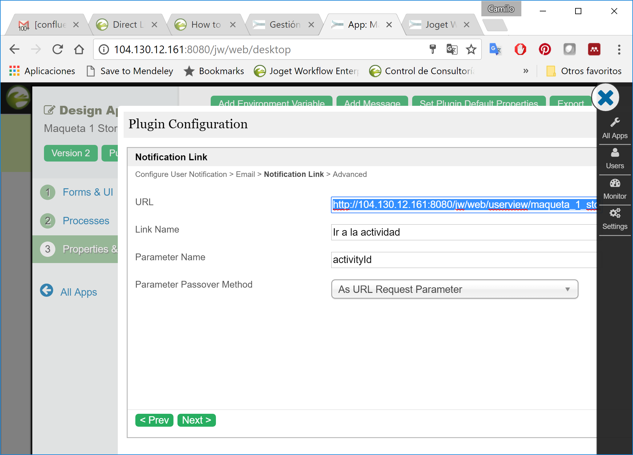

        Hi Camilo,
        Thanks for the response.
        I'm trying to achieve what you're showing me but without using the User Notification Tool.
        Preferably, I'd like to do this using the Email Notification Tool so I can easily customize the content of the email for each assignment.
        Dheren
      2. Camilo A. García
        Exactly, concatenate a link like the one I use to the workflow variable and it should work. The link, of course, depends on the system you have in use.
