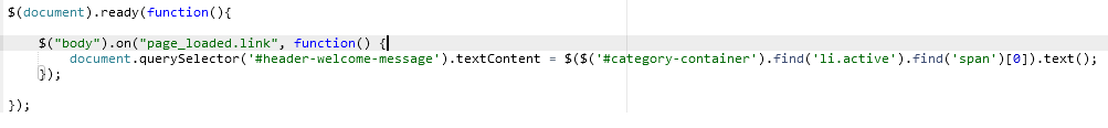

      I found the solution at last. As stated in the comments, within the document.ready block, we need to access the page_loaded event and configure the HTML there.
      By referencing the current usage of page_loaded event on inbox element in the ajaxuniversal, I figured out we would then need to know the correct element for the page_loaded event to be successfully executed.
      After multiple times of trial and error, "page_loaded.link" works correctly as expected when we are clicking on the menu within the category.
      Example of the working code snippet can be seen as below.
      Cheers.

        That's great! Could you share a working code snippet?
      2. NAS
        Sure, done editing the answer with the working code snippet.

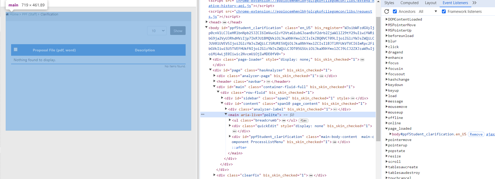

        I already put the custom elements within the document.ready block, as shown below,  yet it still not loaded each time a menu within a category is clicked.
        However, I noticed that, whenever a menu within a category is clicked, the page_loaded event is being triggered, as underlined in image below.
        Is it possible to access the event where the page_loaded is triggered to insert the custom elements?
