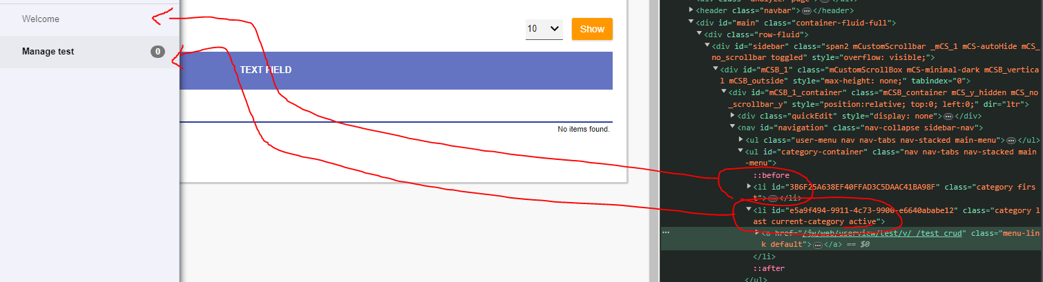

Hi. Is it possible to retrieve the current active category from menu sidebar?
I know there is a hash variable to retrieve the list count of the UI menu, as displayed below, but it is static value and also is not used for what I want, which is to retrieving the current active category.
      i think you can get it using js / jquery.
      looking at the html structure, the active menu item has the class "active" in it.

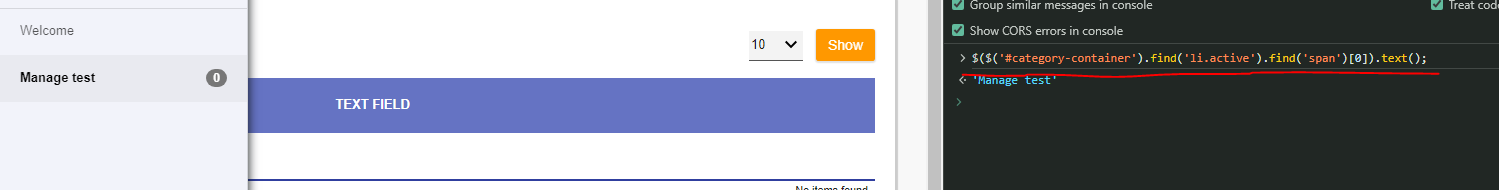

      you can try writing a simple js selector like "$($('#category-container').find('li.active').find('span')[0]).text();" to target and extract the menu text
      1. NAS
        Alright thanks! We still need to access it through js/jquery then to get the active category. I was hoping to just retrieve it from the platform, like how hash variable works, but for not seems like js and jquery is need.
