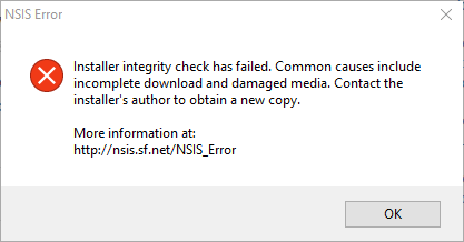

After download Joget from website (i tried enterprise edition V5 and V6) and install on my laptop (window 10), It show error message as following:
This error did not occur when I install community edition.
 Does anyone know how to solve this problem?
Thank you.

          Hi, from the error message it seems like the downloaded installer is either corrupted or incomplete. I just tried downloading and installing the latest 5.0.15 enterprise edition exe and it installs fine. The exe is about 171.4MB in size.

            Hash and MD5 return different from your show to me. Does it mean incomplete download?
