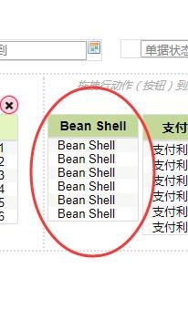

how to custom link? I have wrote some codes,but I don't know how to set the beanshell href, what should I do?
