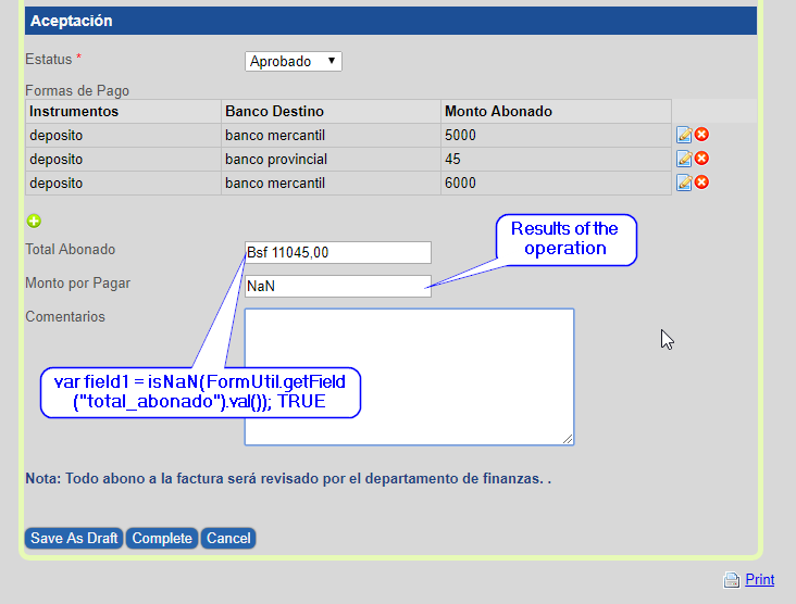

Hi Friends, thanks for your answer,
I think that Your code is very weel for my requirement, but in the variable "amount" i get the value NaN, i did decide to evaluate the content of the fields "total_pro" and "total_bonus" witjth te function isNaN () and surprisingly both throw out true As value, what do you think about this?This is the definitive code

var field1 = isNaN(FormUtil.getField("total_abonado").val());

window.alert(field1); // This show "TRUE"
// window.alert(a);
window.alert(amount); //This show NaN"

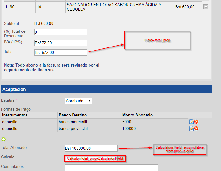

Hi Friends,
I have a calculation field named "BONUS" that sum values from a grid form.
Also I take the value from a field named "total_prod" from a sub-form and need make other calculation like "total_prod" - "BONUS" every time that i increase "BONUS". and store this value to Field in the form.
I´m using javascript to get values , but need help to do the calculation and to copy the field in the "Porpagar" field, that is the same as Calculo in the figure bellow.
