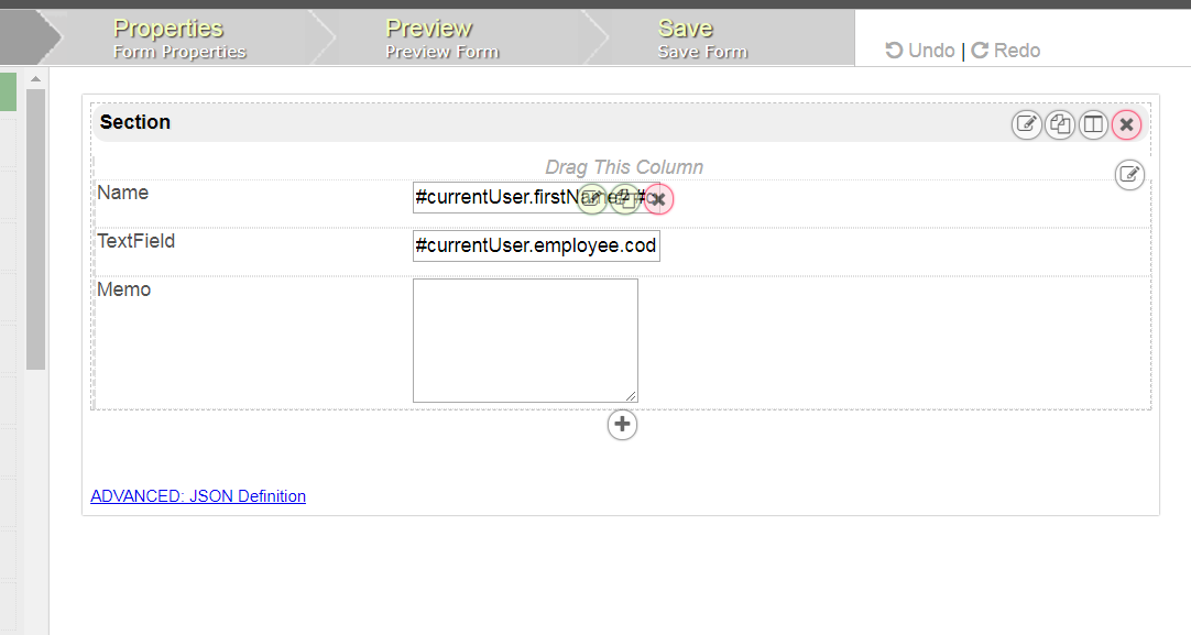

LDAP Directory Manager have problem for retriving value when using #currentUser.employee.code#
#currentUser.employee.title#
Please suggest me .
Joget Enterprise 5.0.x

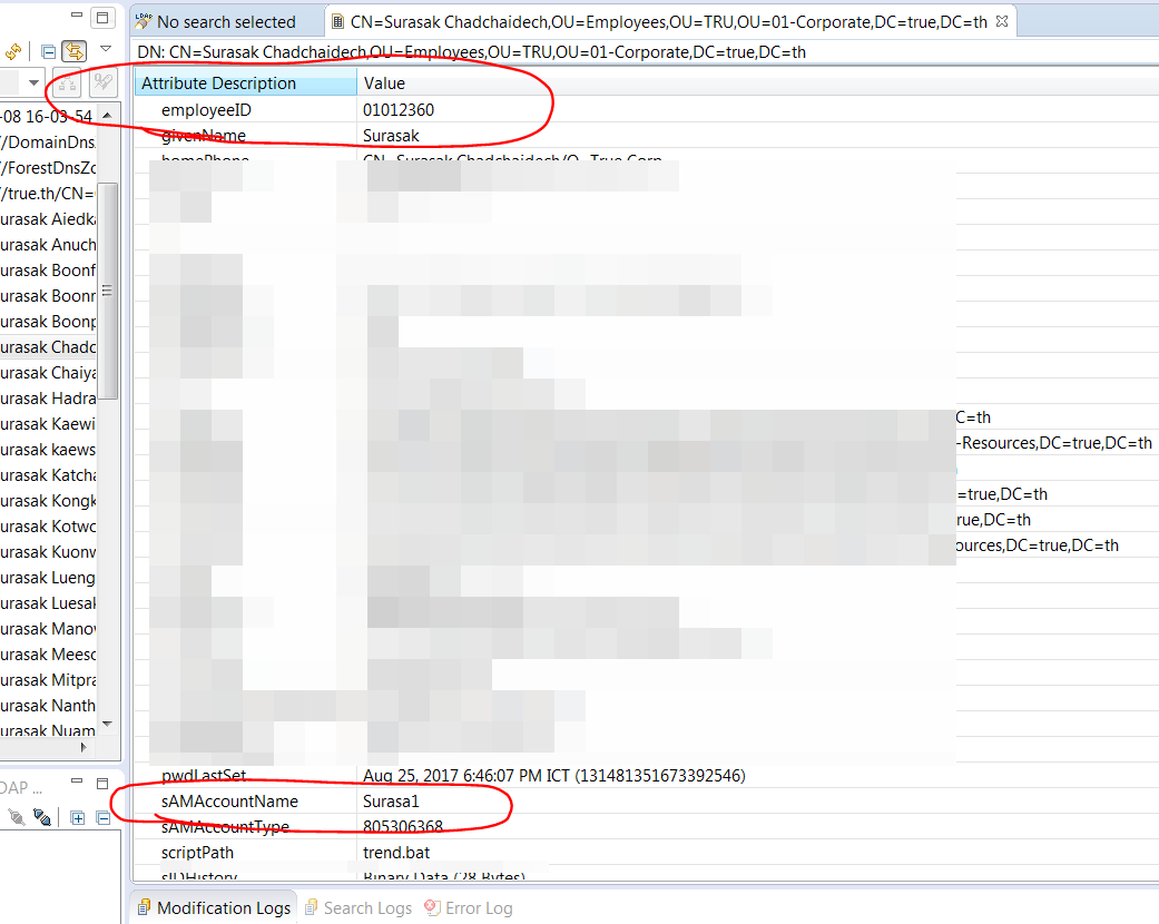

LDAP user - field & attribute

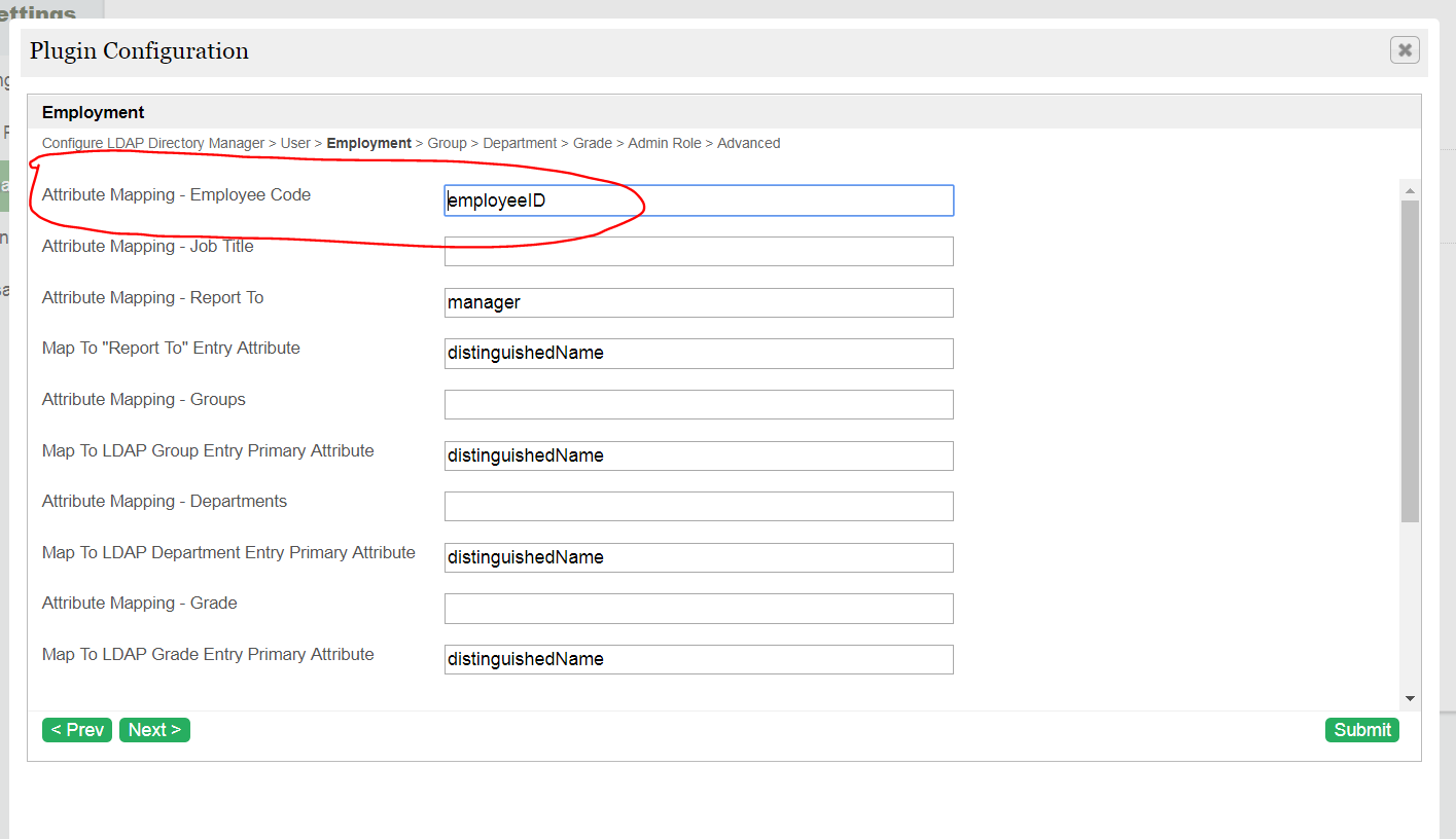

Map LDAP Directory Manager with my LDAP

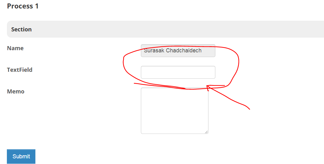

Testing hashvariable with test form
Result :
      I think you need to map the "employment" section inside the LDAP plugin LDAP Directory Manager
