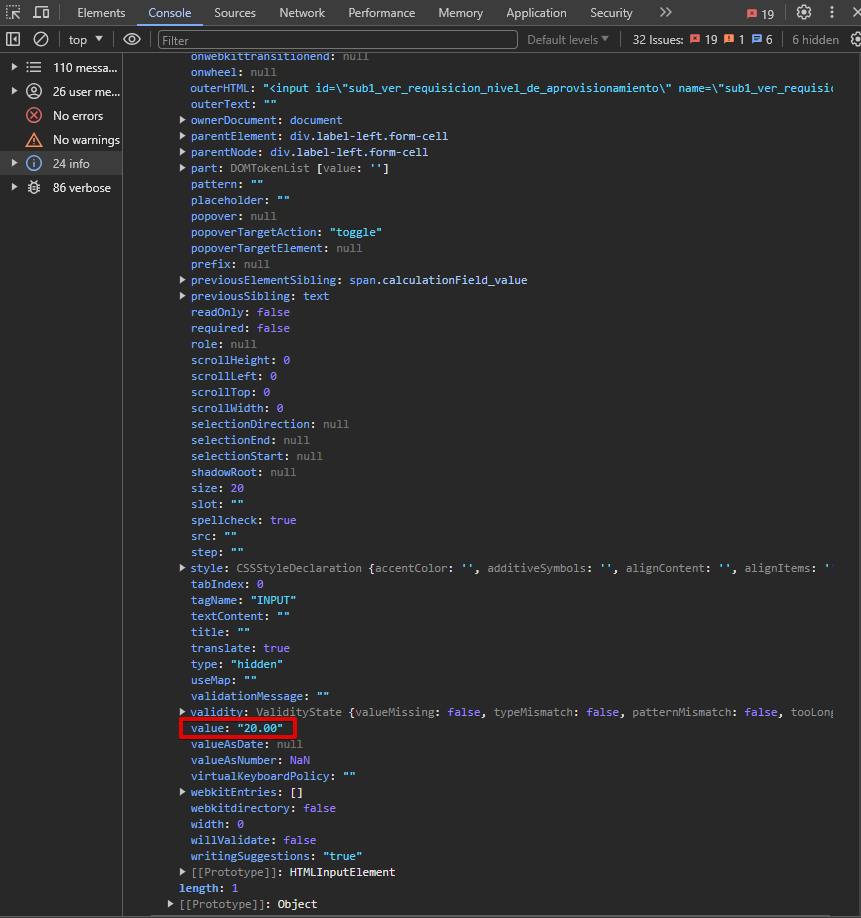

This is the value of the field in the subform

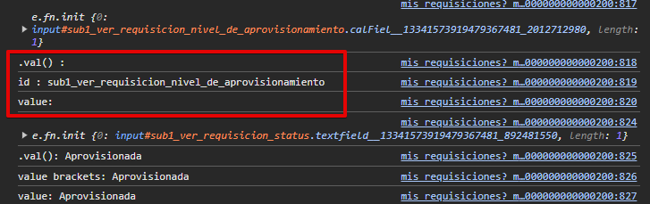

This is the outputs from the fields nivel_de_aprovisionamiento and  status  , the first one is a field type calculation and the second is a list box.
      Hi. it is hard to investigate on what is happening within your form without seeing the app/sample app.
      However,
      this KB have the exact requirement that you want Getting Value of Subform.
      You can modify the code to adjust to your requirement of getting several other values and pass it to the set variable.
