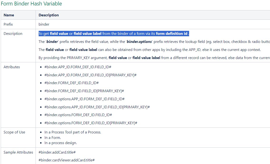

Example: your table is registration. to get the primary key is:
#form.registration.id#
try using#binder.FORM_DEF_ID.FIELD_ID#
Refer here for detailed explanation Hash Variable#FormBinderHashVariable:~:text=with%20curly%20bracket.-,Form%20Binder%20Hash%20Variable,-Name
There is also a sample app attached in the KB for you to explore.
