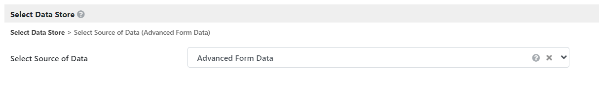

If both of the columns are from different forms(Which from different tables)
you can make use of the Advanced Form Data List Data Store
You can join both of the tables .

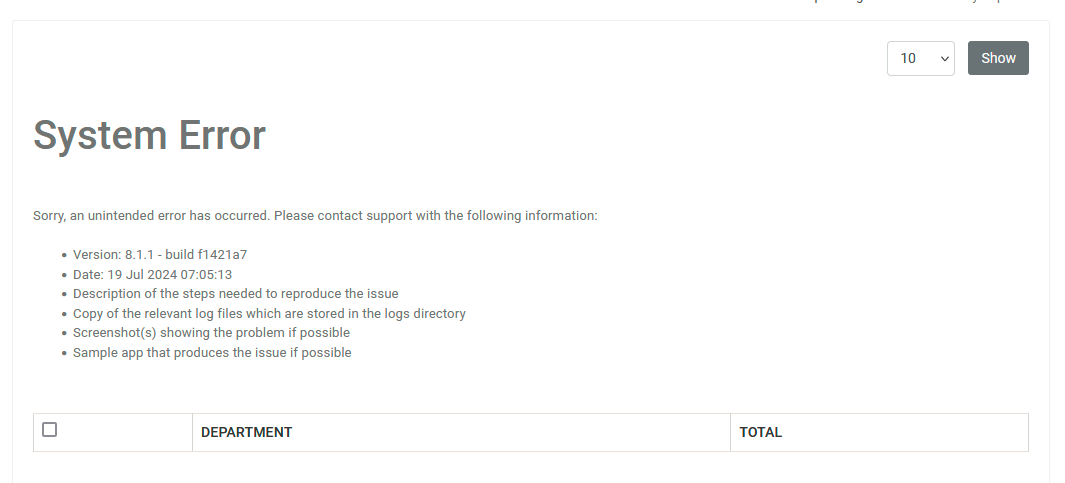

ginger, can you help me, i try to do the datalist using sql but it appear error : ERROR 19 Jul 2024 15:05:13 /jsp/dbuilder/dataListView.jsp - Error rendering datalist

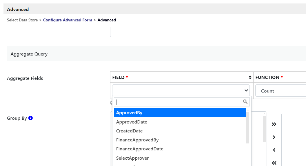

Change the data store and you can Try to use the aggregate query to have the application column to be count up using the existing feature?
try to have it a go.
