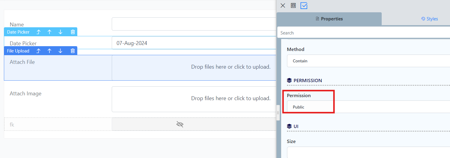

set fileupload permission to public
reference: File Upload - Knowledge Base for DX 8 - Joget | COMMUNITY

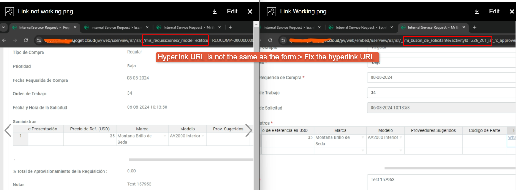

hi,
Please ensure :
1 ) Hyperlink URL is correct >2) Ensure the permission in your file upload is also set to public >

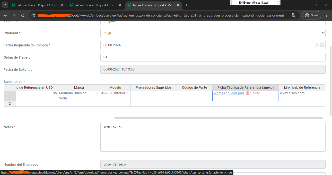

Figure 1: This is the form that use the user in the process flow, bellow is the URL that anonymous can access to download the file without problems

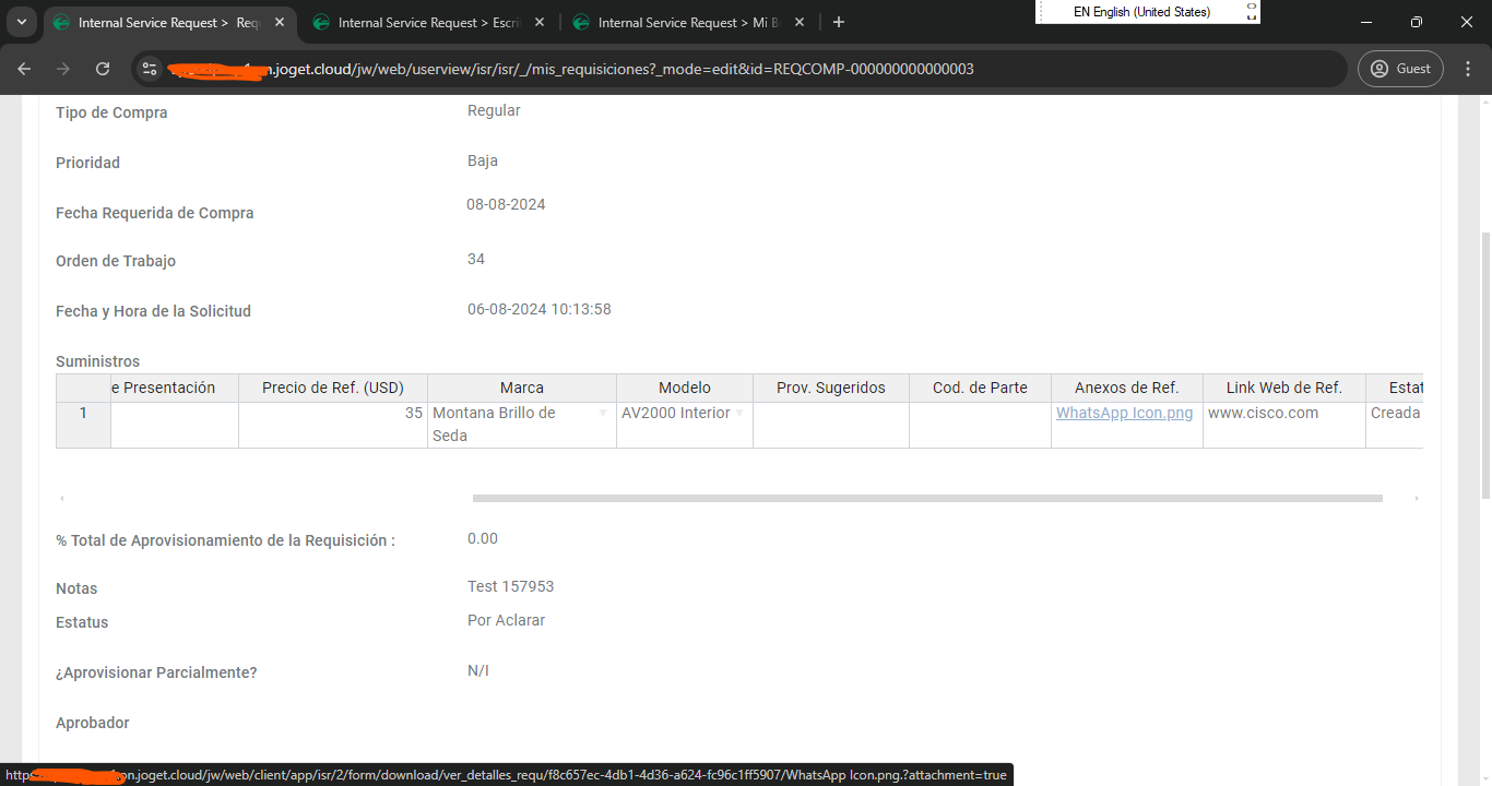

Figure 2: This is the form with problems , it is called from hyperlink from a datalist , note that the user (anonymous) can access to the parent and child record, also can see the URL where to point the file

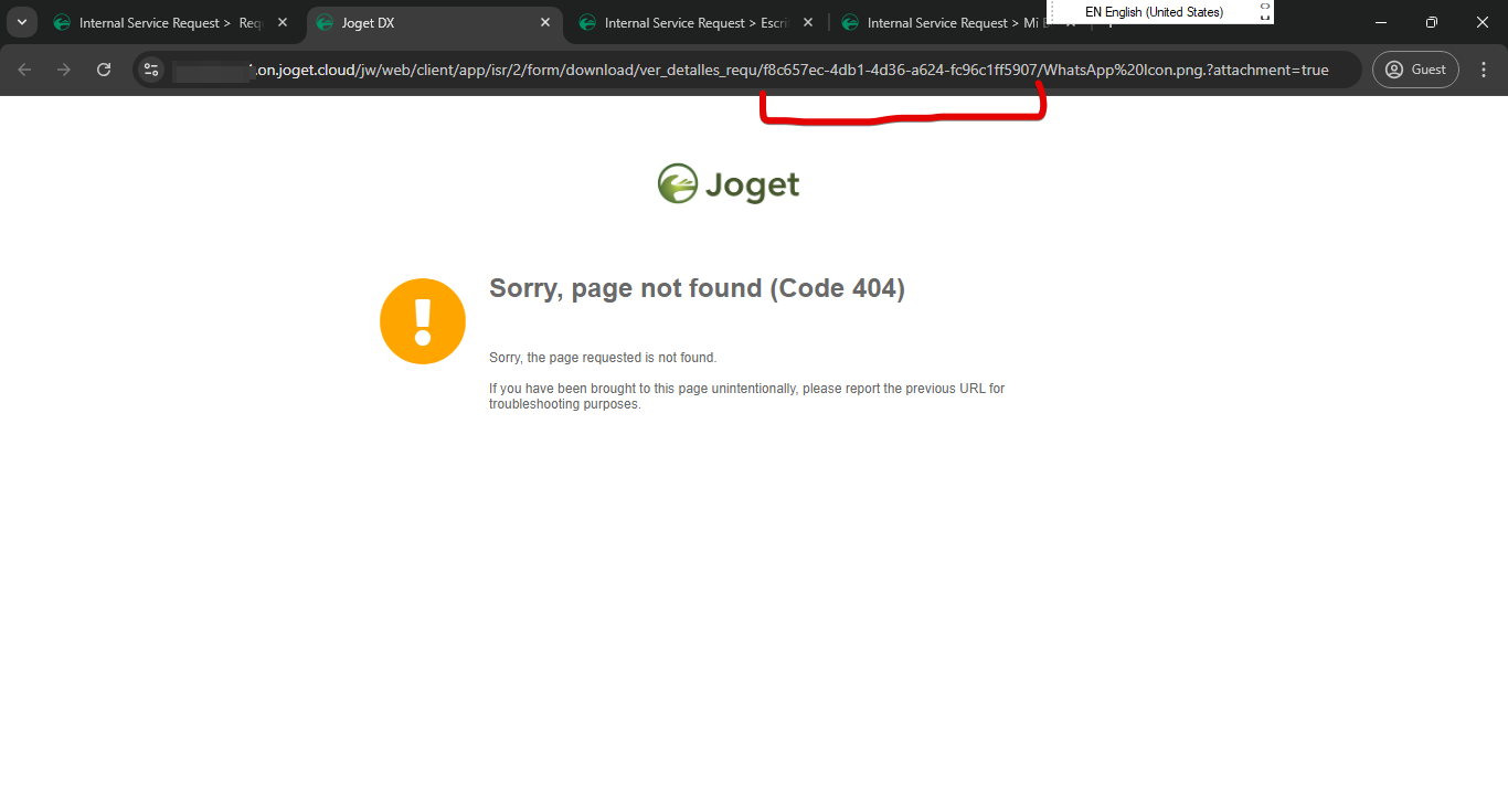

Figure 3: When I do click I get an error message in this case
