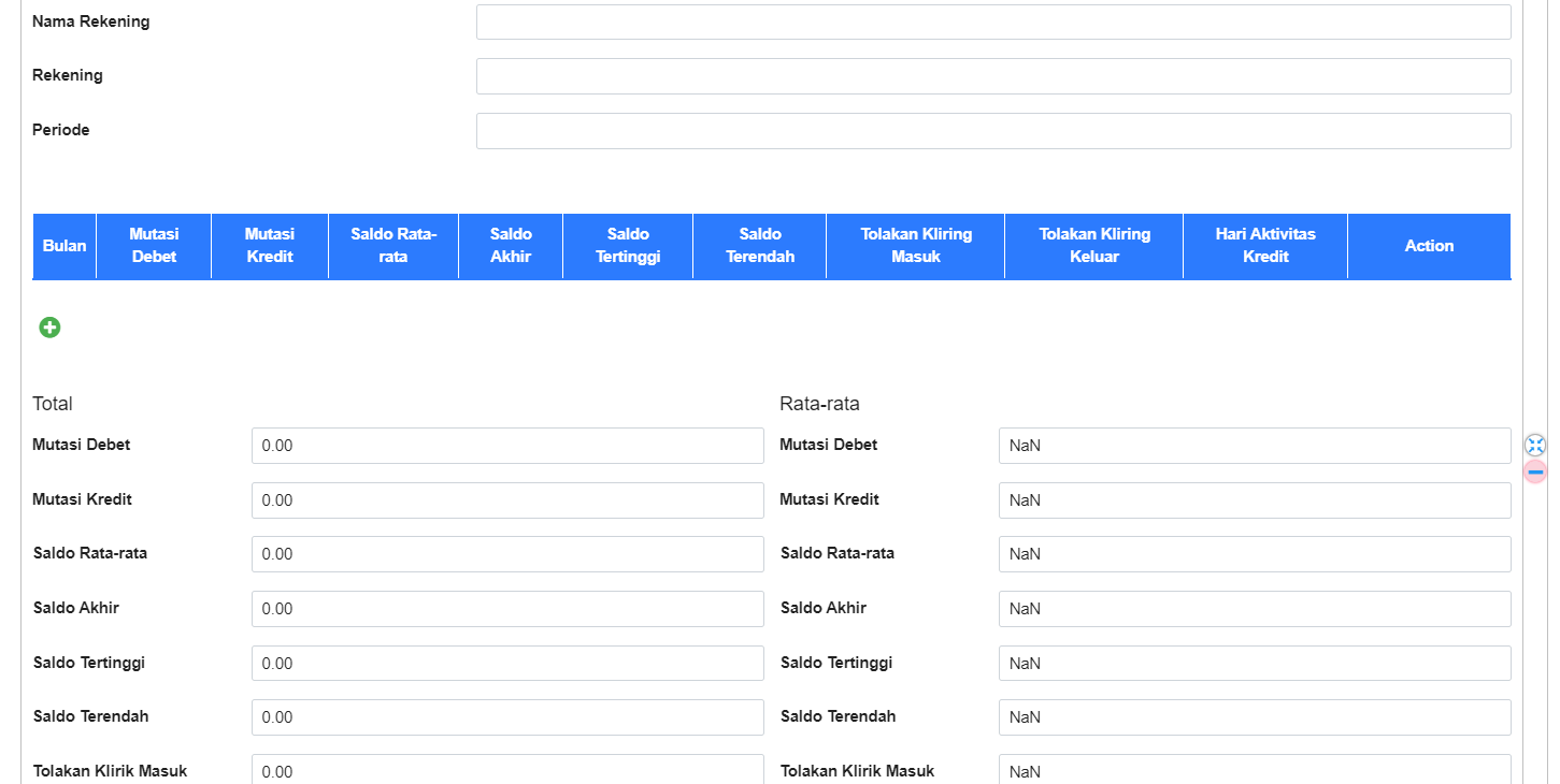

i have issue when use subform repeater 7.0.9 if form have grid/form grid because somehow the add field didn;t show and calculation javascript didnt work.

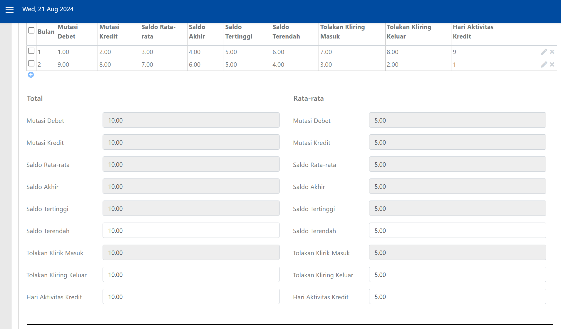

but when i try subform repeater 7.0.7 is working as expected. and caclulation javascript is working
i can;t try 7.0.10 because my joget v6 didn;t support i think because when i try upload plugin can;t be add.

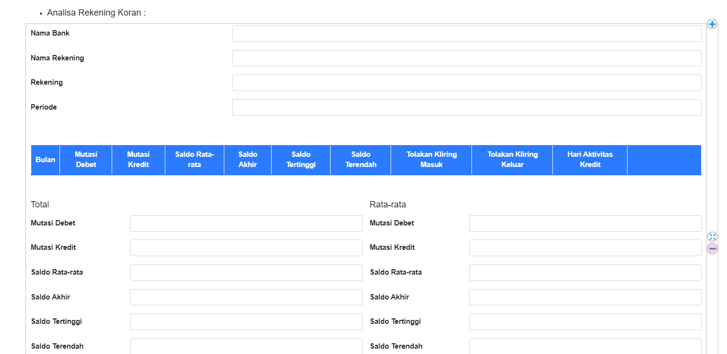

this after continue question this reissue subform repeater when insert or submit second time
you have a sample app you can share? i can try on dx7 or dx8....but i don't use v6. i know there was an issue in the form grid calculation dx8.1.3 and i believe they fixed it in dx8.1.4
APP_subfom_repeater-1-20240816164742.jwa this is sample on.
