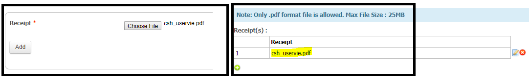

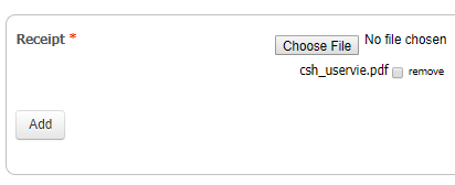

In 'manage form', when you click the add('+') button, you will be selecting a document to attach and click 'Submit'.
The file name appears in grid.Click on the edit button to view your attachment. You will not be able to download the file.

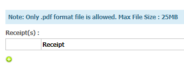

This is the problem I'm facing at the moment. I want to view the attachment before saving the form. Can this be done?
- Andrew
Hi You will not be able to view the attachment before saving the form because the attachment has not been retrieved yet. The attachment will only be copied into the Joget Workflow server's hard disk after you click on the "Submit" button.
- Shubana Vijaya Kumar
Thank you for the clarification, Andrew.

I'm unable to view the uploaded file before I submit the form.
Is it possible to do so?
Example of scenario :
1) New Form submission. Click on '+' to add file
2) File is uploaded/added
3)Click on Edit button.
Unable to download the file.
