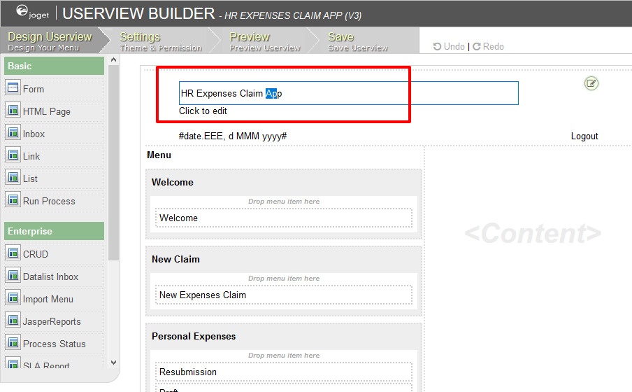

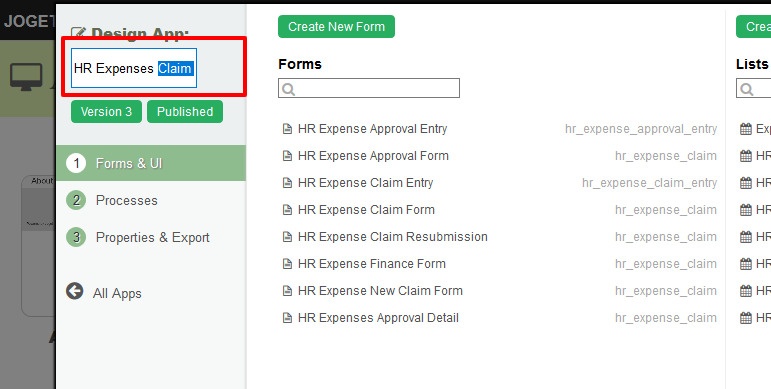

Depending on your needs.
1. In the App Design screen.
2. In the Userview Builder
- de villers
Hi ! thank you Cactus ! the two replies are both interesting :) Fred
