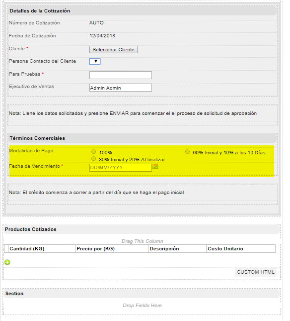

Hi Team I have a form that have a sub-form , an need hide a section in it regarding a value of a ratio form located in the sub-form.  How can i do to reffer to teh value of this value?

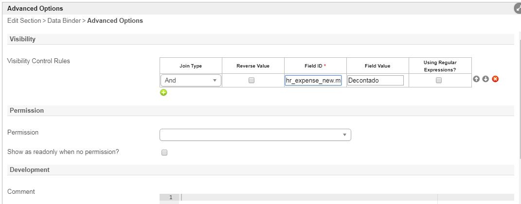

      Hi, you can do it with [subformFieldId].[fieldId]. Eg, my subform field is "details" and the field is "type", I can use "details.type" for control field.

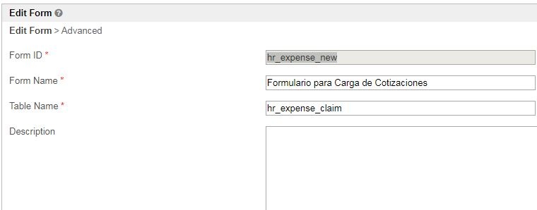

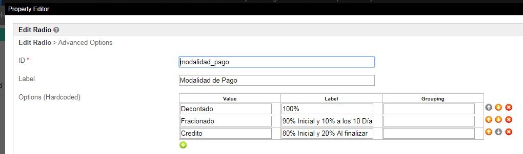

        Hi Friend, in my case the subform id is = hr_expense_new and the radio tool ID is = modalidad_pago as you can see in the images i did use hr_expense_new.modalidad_pago and don't work ,is this example as you did explain?
    2.
            Definitivally to use this feature the control must be in the same form friends ¡ Good Look¡
        Sorry but don´t work do you can share an example or app with this case?
          Hi, in the first pic you posted. Look like your field is in a subform of a subform? in this case, you may need to try syntax like subform1.subform2.field1.
            Radio Control (inside the subform)
            subform ID
            SECTION Visibility Control Rule
