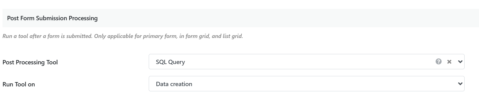

in Form 1 , go to Form Builder > Settings > Advanced > Post Processing Tool
and use
- SQL Query Tool - do a query to insert data into form 2 table
- Also check whether this tool should run only on creation of form 1, update of form 1 or both
tThis way, the moment you click on save, it will run the SQL Query to say insert selective or all data from Form 1 into Form 2

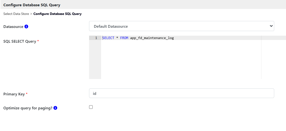

there is not data is actually being created in the list
my list is also fetching from the database - Ian

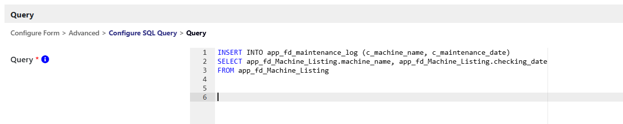

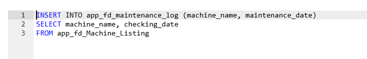

any user created fields will have a prefix of "c_" . so if your field is called "machine_name", in sql Query its "c_machine_name"
reference: Database SQL Query - Knowledge Base for DX 8 - Joget | COMMUNITY
- M Tarek Hamwi
I already made it into c_machine_name
but still not showing
it is not creating a new form and showing in the list - M Tarek Hamwi
this is currently the updated sql
but still not working
