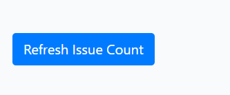

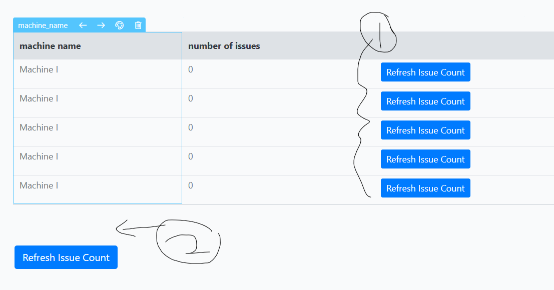

it work on the (1) but not on the (2)

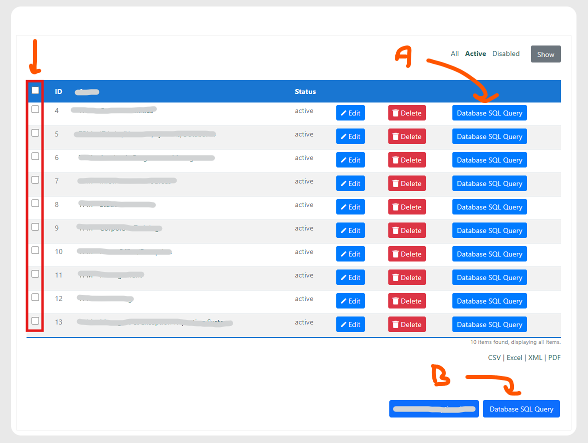

Turned out that button (B) only works when having a row selected,
can you try selecting a row and then clicking the button?
why is inside the list if i place the the Database Sql Query for each for and run a code
that code will work
but then when i place that database sql query outside
the code won't be exuected
just like a simple sql line for example
delete from table
the same exact code run in (1) but fails in (2)
is there any reason why ??
