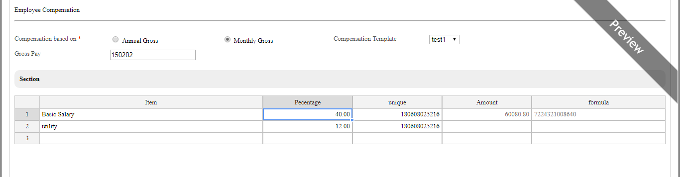

I am calculating compensation due to personnel.
The spreadsheet is in an Ajax subform loaded by the compensation template selected.
The first 3 columns are loaded from a table into the spreadsheet using multirow form binder.

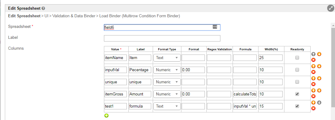

The setting for the spreadsheet is
I am using the following script taken from Prepopulate a grid with data via Javascript to calculate the amount.
<script> function calculateTotal(amount) { var pay = FormUtil.getField("grossPay").val(); if (pay === undefined || pay === "") { pay = "0"; //set a default } return (amount/100) *pay; } </script>
The formula only calculate after i have manually updated the percentage cell but I would like the calculations to occur on loading the spreadsheet without user interaction.
How can i trigger the spreadsheet to update or recalculate cells by script.
thanks
Can you please elaborate on "some rates using some predefined templates" and "select the template using selectbox."?
Is the value already readily available in other columns? If yes, it is just a matter on keying it in into the "formula" field like what is documented in Spreadsheet
Can anyone one tell me how to get the spreadsheet element to do calculations automatically.
I need to calculate some rates using some predefined templates. The user enters an amount in a field and then select the template using selectbox.
the template is loaded in the spreadsheet element by multirow form binder but the calculations in the spreadsheet are not updated unless i manually edit an effected cell.
