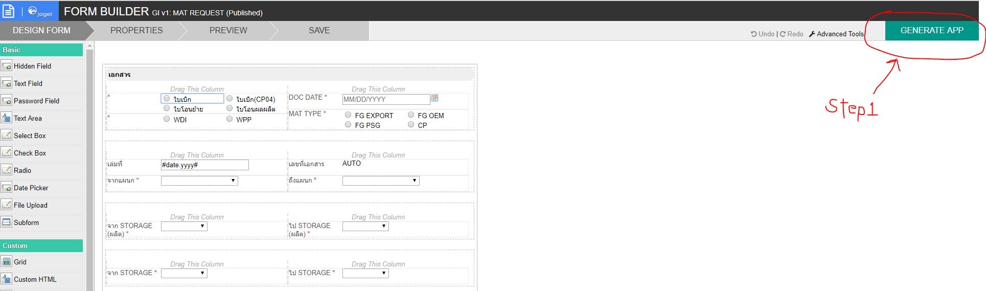

Hi, What generator do u use in the APP Generator? The app generator is a helper to generate some feature based on the provided templates.

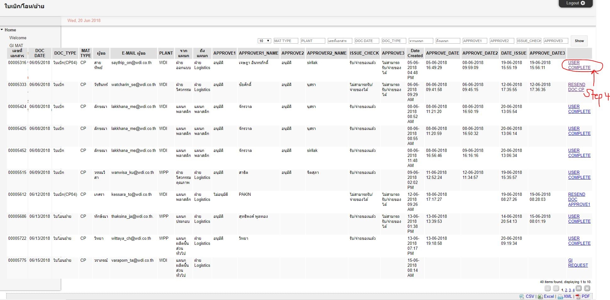

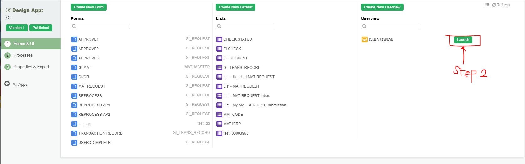

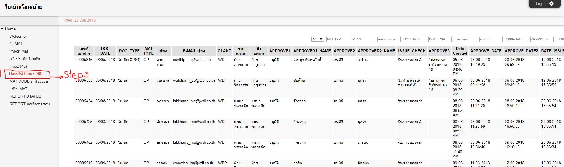

Ur screenshot shows it is a datalist inbox, so the link should be an assignment link. I can't remember there is a generator hv activity called "User Complete".
May be u can provide ur sample app here? So, we can help take a look?
- Justin
There doesn't seem to have any row actions used in the datalist here. I'm not sure if there are any custom javascript/html codes in use that provides those extra functionality. I would suggest that you may provide us your tomcat log & sample app (if possible) for further inspection. Thank you.
- Justin
I suspect that the custom code responsible for the datalist action above is flawed and retrieves NULL value when code is trying to obtain (possibly) record id for the correct assignment.

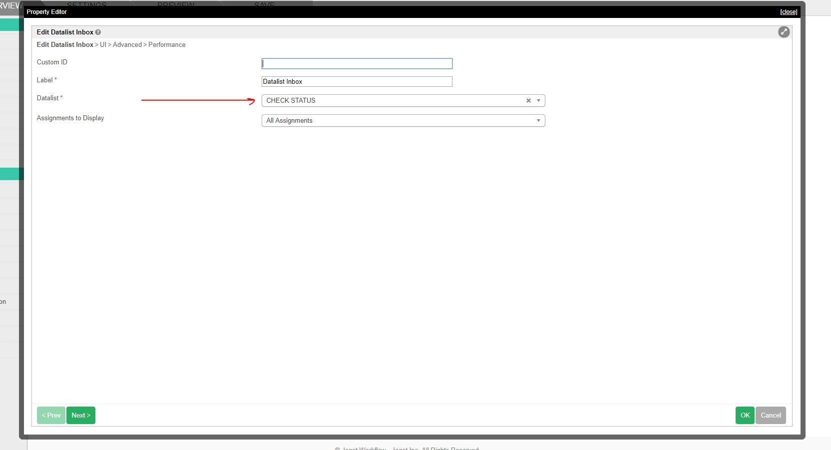

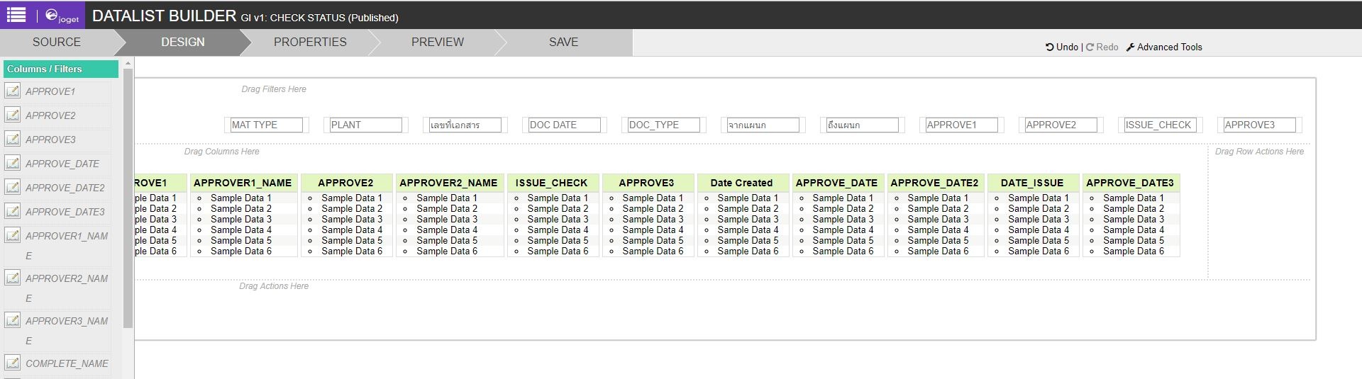

this you mean to see datalist?
- Justin
Yes. I meant is, the datalist action - "USE COMPLETE", belongs to one of your datalist available in your app. The Datalist Inbox then refers to that specific datalist to display information. Inspect the configuration of that datalist action for any mistakes.
- it_wdi

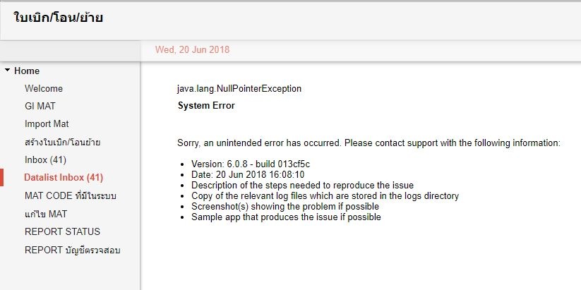

picture comment below
java.lang.NullPointerException
System Error
Sorry, an unintended error has occurred. Please contact support with the following information:- Version: 6.0.8 - build 013cf5c
- Date: 20 Jun 2018 16:13:24
- Description of the steps needed to reproduce the issue
- Copy of the relevant log files which are stored in the logs directory
- Screenshot(s) showing the problem if possible
- Sample app that produces the issue if possible
Add your comment... - 10-1Add your comment...
