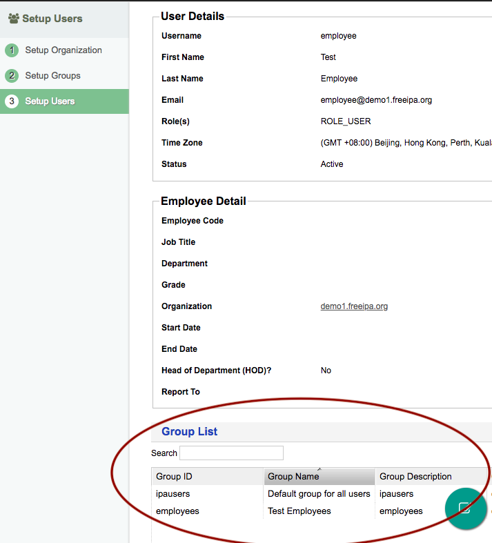

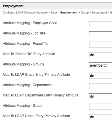

It turns out that this was a bug in versions earlier than "6.0.9". I've just upgraded from version "6.0.8" to "6.0.9" and the configuration seems to work now. However, I just noticed another issue: the "report to" field is probably had the same bug. Here's my setting for "report to" fields: Attribute Mapping - Report To = manager Map To "Report To" Entry Attribute = dn Could you please help me on this Walter :)
There's a tab called "employment" in the LDAP config, try to fill that up too and go to the last tab to turn on debug mode to get more details printed out. LDAP Directory Manager

I've just tried filling up every field of the "employment" section. I've also tried playing with LDAP configuration but still have the issue. The debugging logs weren't helpful--check them out at the bottom of the question. Could you please try integration the demo server mentioned in the question yourself.

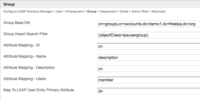

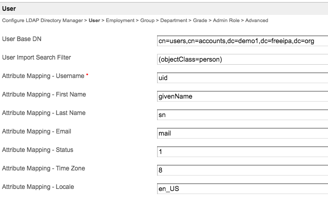

I successfully managed to integrate Joget with LDAP server (FreeIPA) using LDAP Directory Manager plugin. I've got all the users and the groups, yet I'm unable to link the users to their groups and vice versa --"group list" in user details and "user list" in group detail are both empty.

LDAP Directory Manager configuration:
