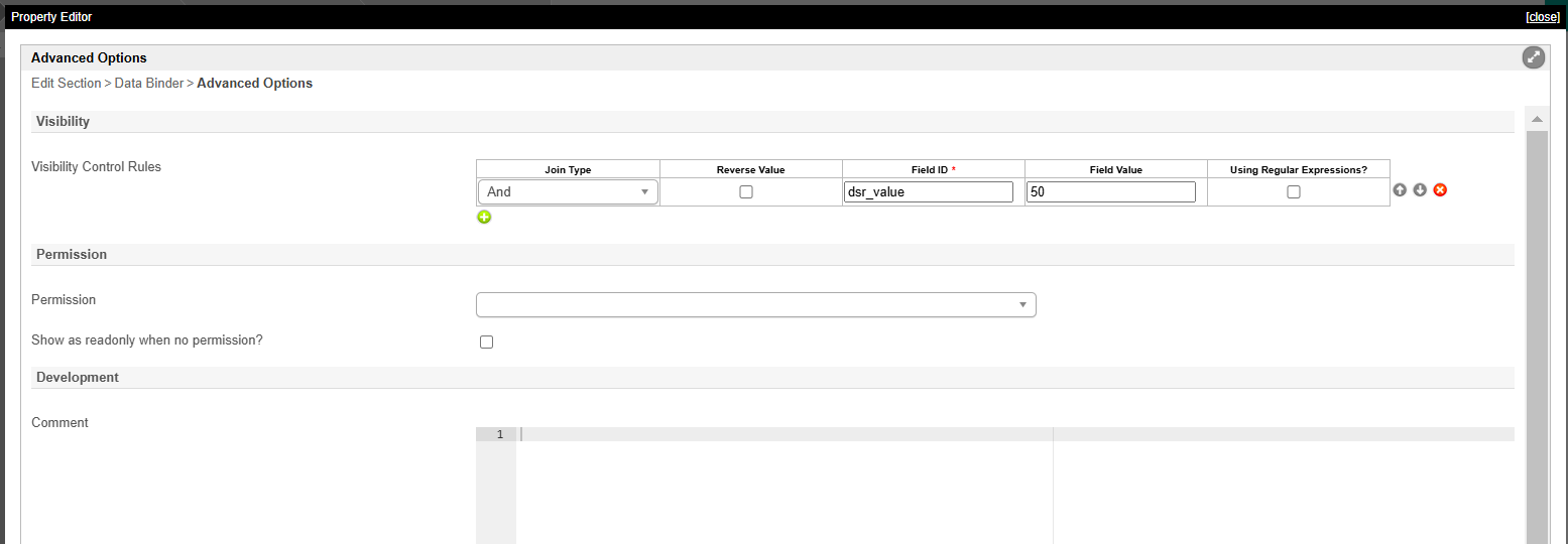

the visible control on advance option section didn;'t working
so how i can make advance option visiblity working when using javascript to set value?
      Hi Galvin,  when you update a field value using javascript / jquery, you need to trigger the change event for the form to recognize it and show the section.
        var dsrValueInput= $('#dsr_value');    dsrValueInput.val(50).trigger('change');
      Hope this helps.
      1. galvin
        Thanks is working when add.trigger
