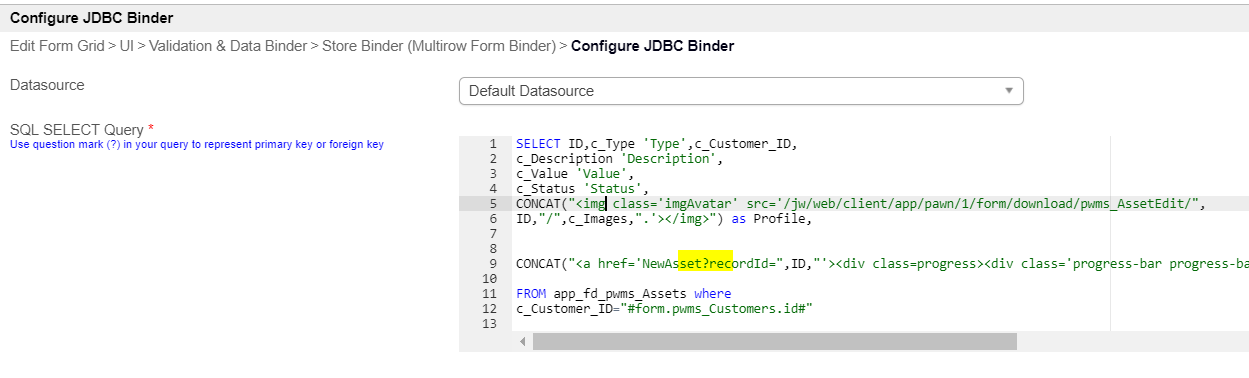

I'm placing a hyperlink in the form grid using JDBC binder. If I use the question mark in the string, it throws a java error (presumably because ? is a variable for the preparedstatement).  How can I use the '?' in JDBC binder? Thanks. See yellow highlight below.

      According to this link --> https://stackoverflow.com/questions/26516204/how-do-i-escape-a-literal-question-mark-in-a-jdbc-prepared-statement
      Except for PostgreSQL where question marks are escaped with double question marks (??), usually other databases does not require any additional steps to escape a question mark in a literal string.
      Hope this clarifies.
        I found that you have to use CHAR(63 using ASCII) instead of ?
