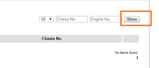

I have one datalist which is used for searching my assets
.I just wanted to know,whether the default 'Show' button can be renamed .

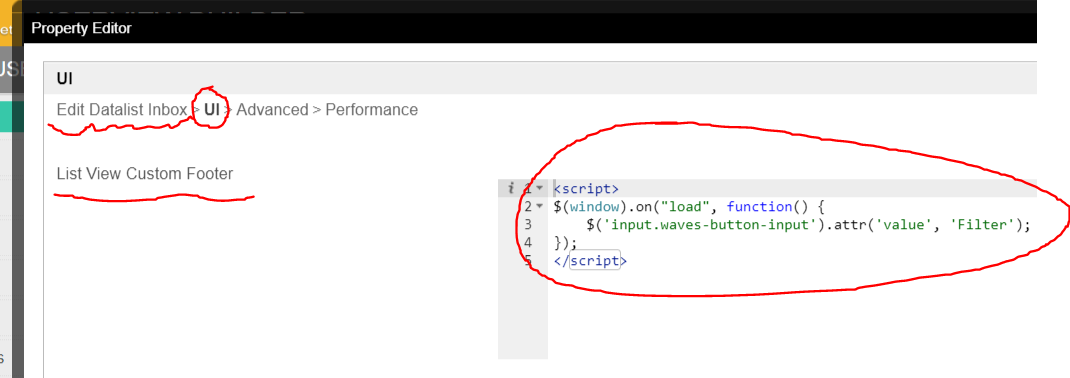

      Certainly! Just go to your Userview, edit your list, go to the UI tab, and paste these codes in any of the available custom header/footer.
      <script>
      $(window).on("load", function() {
          $('input.waves-button-input').attr('value', 'Filter');
      </script>
      You can refer to my picture attached below for an example.
      Hope this helps.
      1. gb
        Thank you for your response But this is not working . I have tried as mentioned in below discussion. In that case it is working , But theme is changing and button name is changing in other page as well. https://dev.joget.org/community/questions/31131302/joget-datalist-jquery-manipulation
