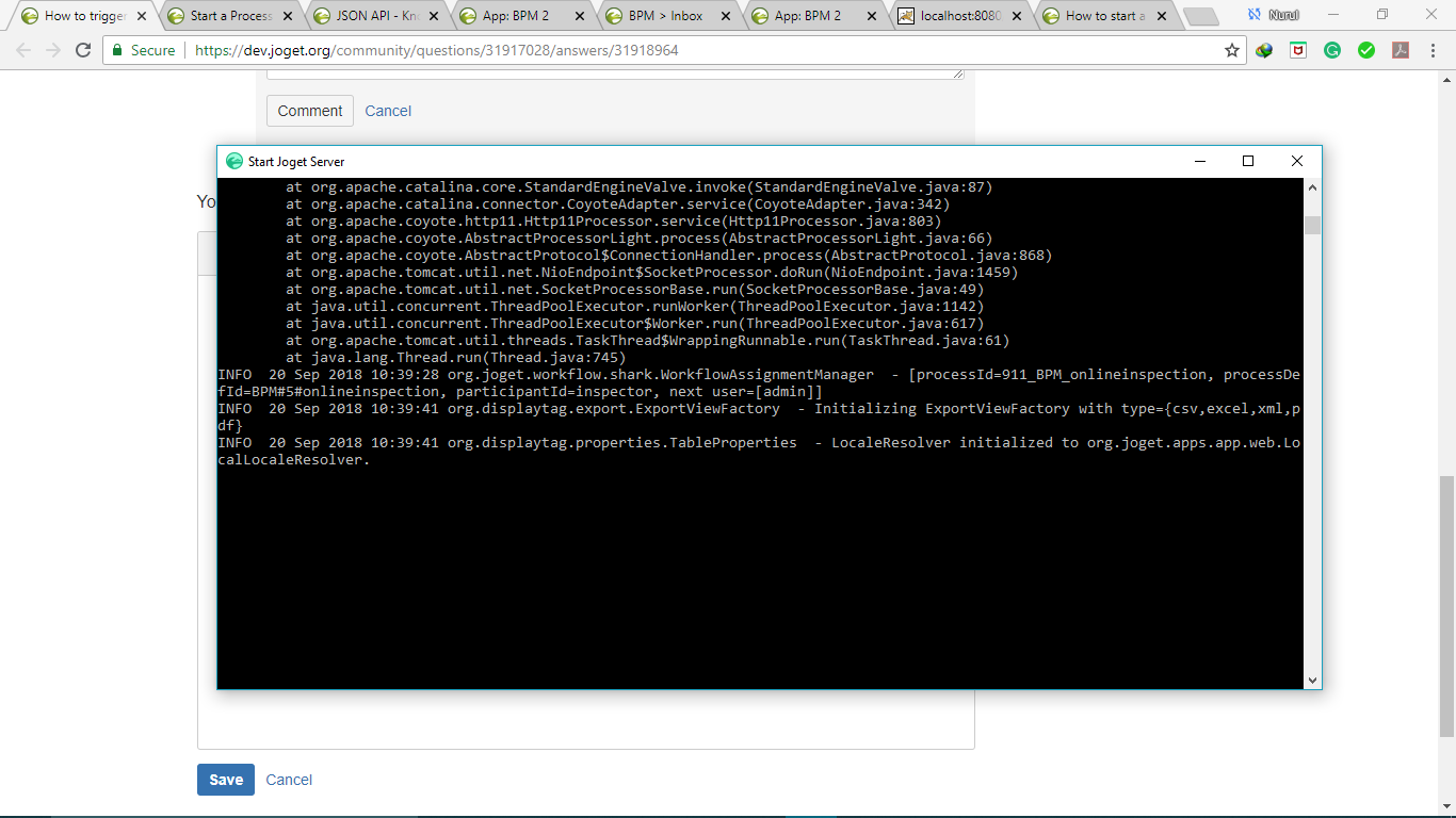

Hi Justin,
Here is the server log, nothing happened when I click on the trigger button.

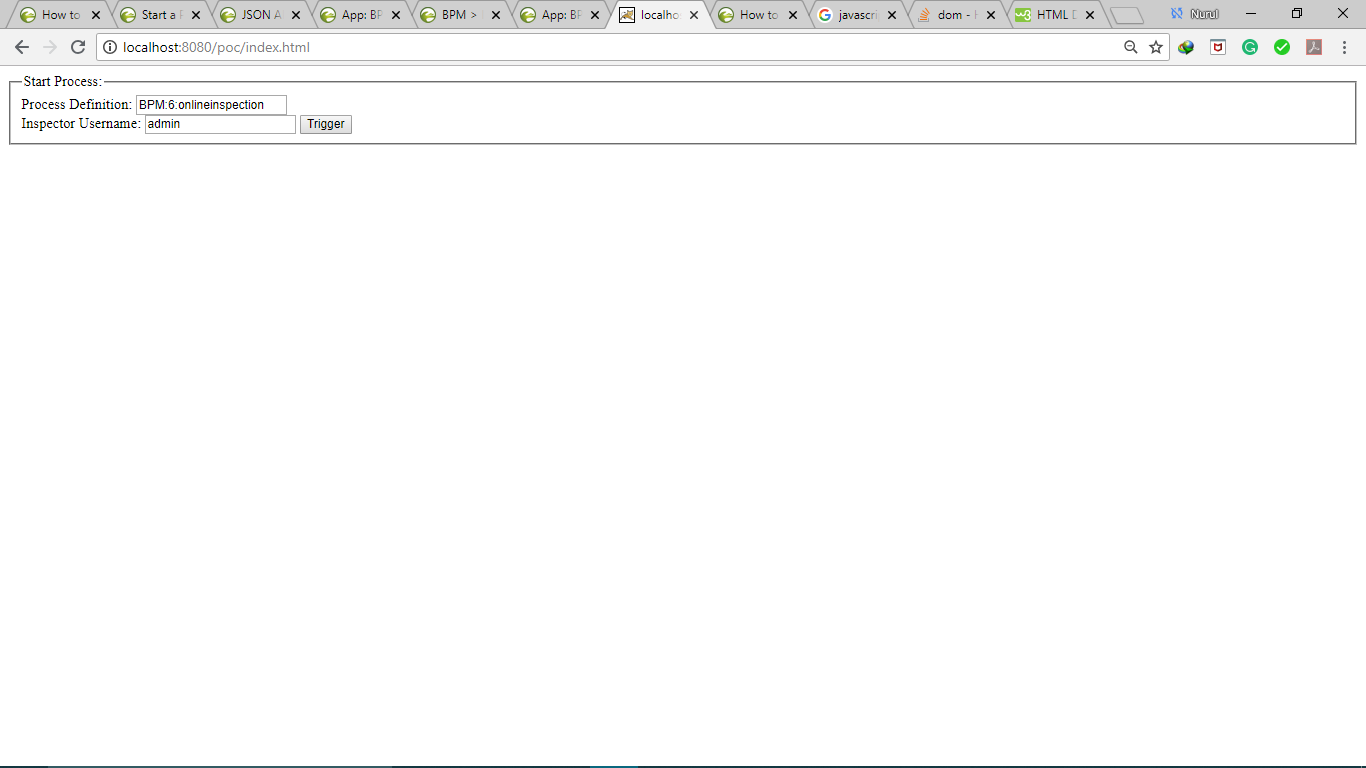

Right now I follow exactly like the tutorial which I sent you the link above, Below is the index.html page, but I did not get any output.
- Justin
Seems like from your server log, there are processes started already.
- Justin

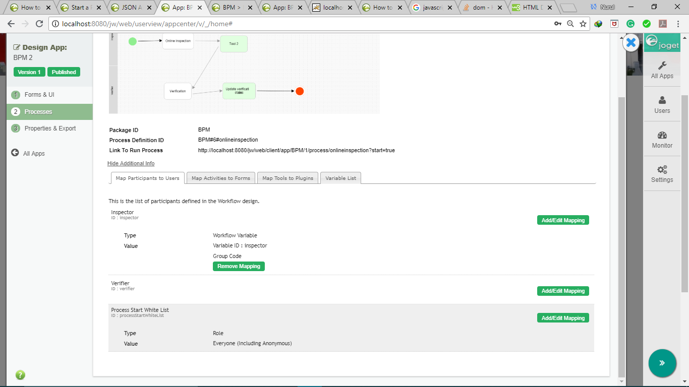

Also check your Process Monitor if there are process started already.
