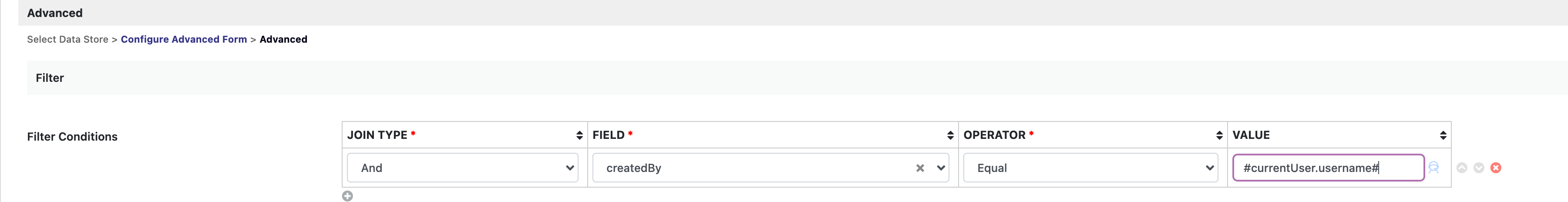

I'm working on an app in Joget where different users can log in and submit health reports. I want to make sure that when a user logs in, they can only see their own report history (not other users' submissions).
I'm currently switching between different users for testing, but I noticed that the list shows all records regardless of the user.
How can I filter the data so that each user only sees their own submissions in the list or datalist view?
Do I need to use a custom filter or is there a built-in way to do this in the List Builder?
Thanks in advance!
      Hi Quem, in your datalist you can add filters to show only current logged in user's record. Please refer the below screenshot. Hope this helps
